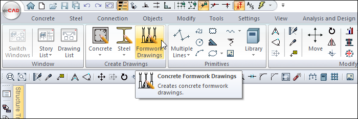

You can access it from the Drawings tab under the Create Drawing heading.

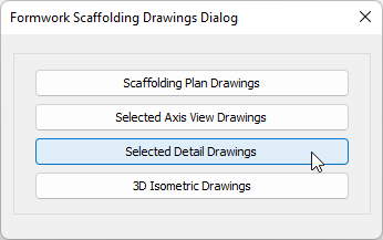

  • Click the formwork drawings icon. The formwork scaffolding drawings dialog will open.
  • In the dialog that opens, click the Selected Detail Drawings button.
  • Scaffolding plan, view and 3D isometric drawings of the selected element or elements will be created.

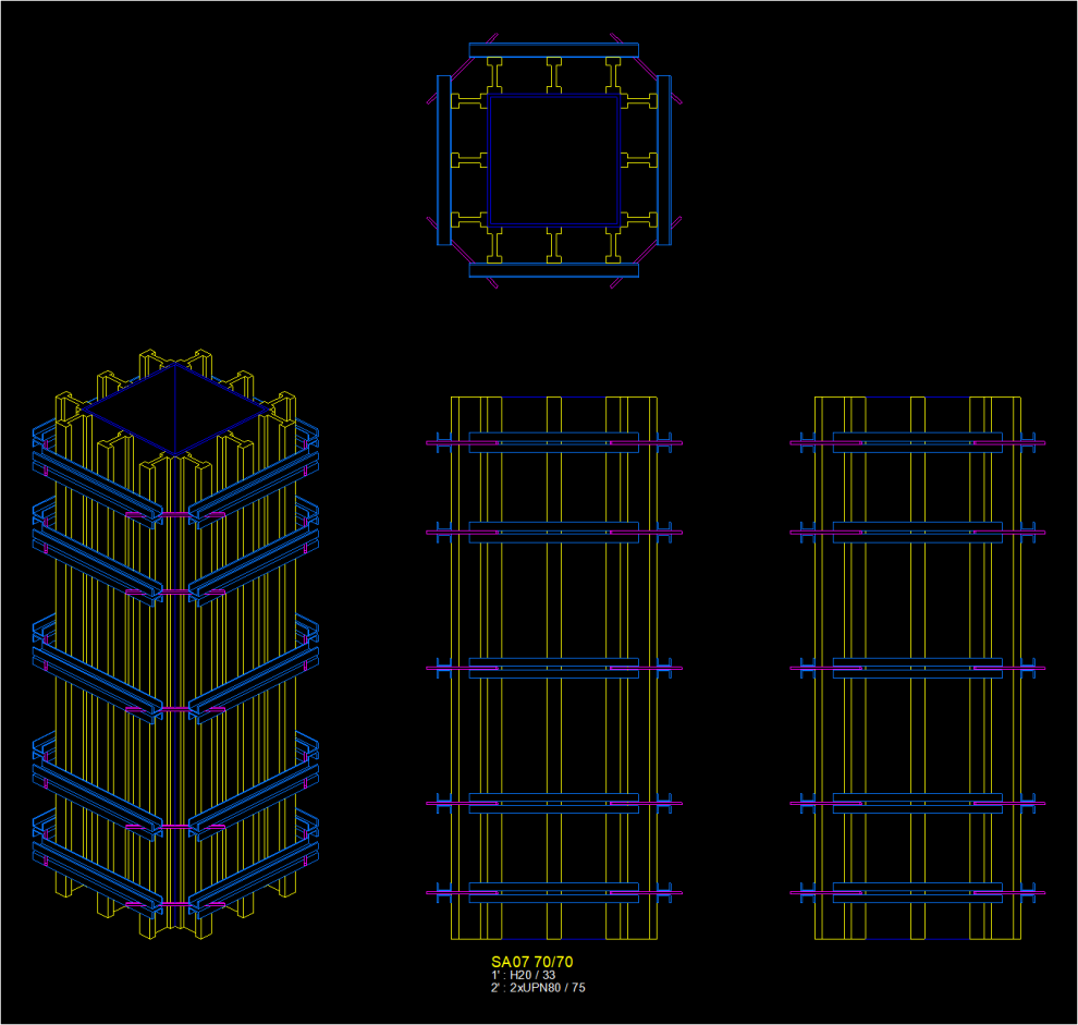

Column detail drawing

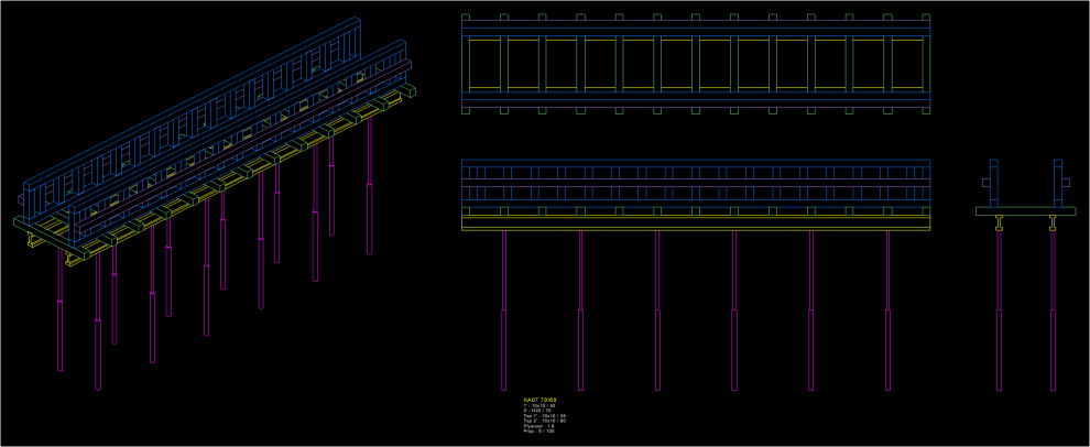

Beam detail drawing

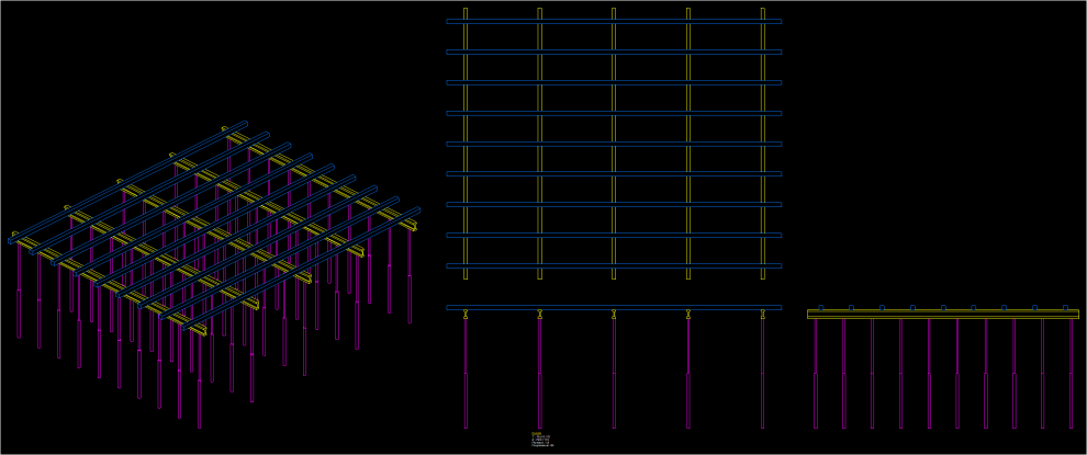

Slab detail drawing
