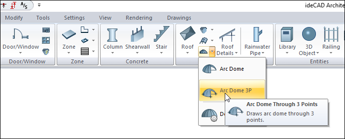

Creating an Arc Dome 3P
An arc dome is created between three points determined by the Arc Dome 3P command.
Location of the Arc Dome 3P Command
In Architectural Program
In Structural Program

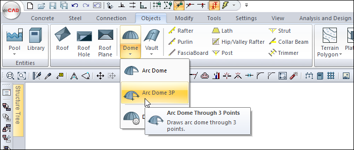

  • Click on the arc dome 3P icon.
  • The Dome toolbar will open.

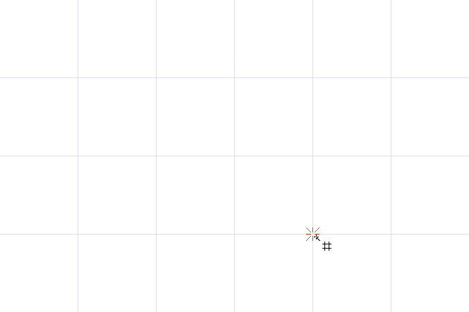

  • Determine the first point of the arc dome by clicking on the drawing area with the left mouse button.

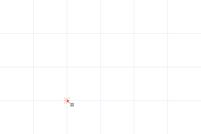

  • Determine your second point by moving your mouse over your second point and clicking the left button.

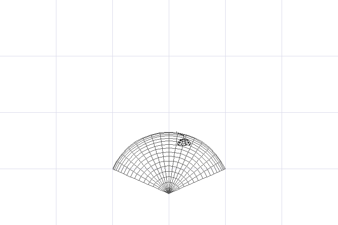

  • A virtual image of the dome will be created, it will move with the mouse cursor.

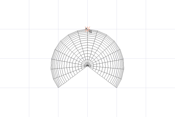

  • Determine your third point by moving your mouse over your third point and clicking the left button.

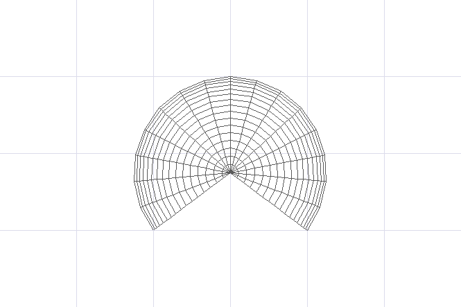

  • An arc dome will be formed from 3 points. Exit the command with the Esc key on the keyboard.
Determining the first point of the arc dome by clicking with the left mouse button
Determining the point of the second point of the arc dome
Formation of virtual image of arc dome and changes depending on mouse movement
Determination of the third point of the arc dome
Formation of an arc dome 3P
