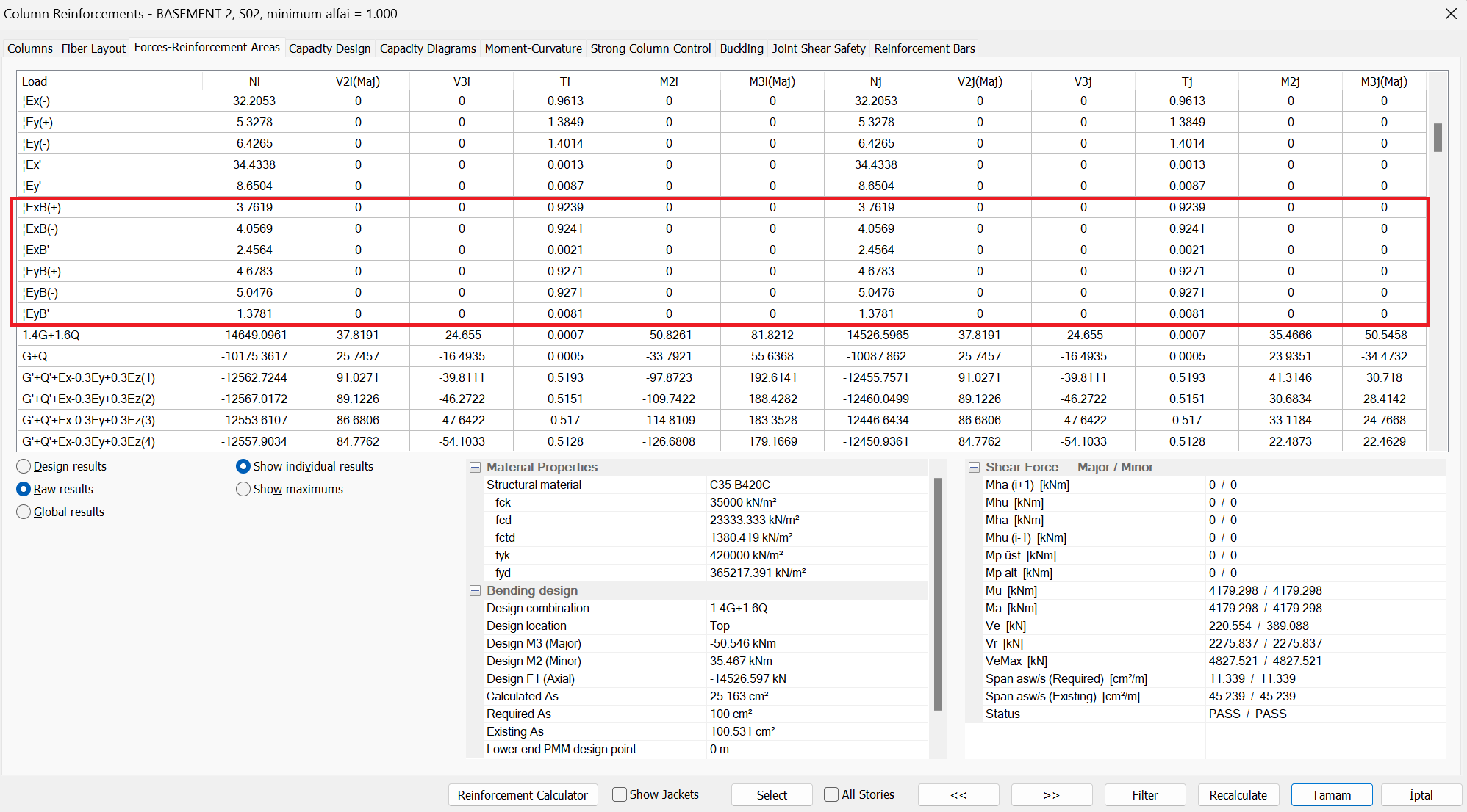

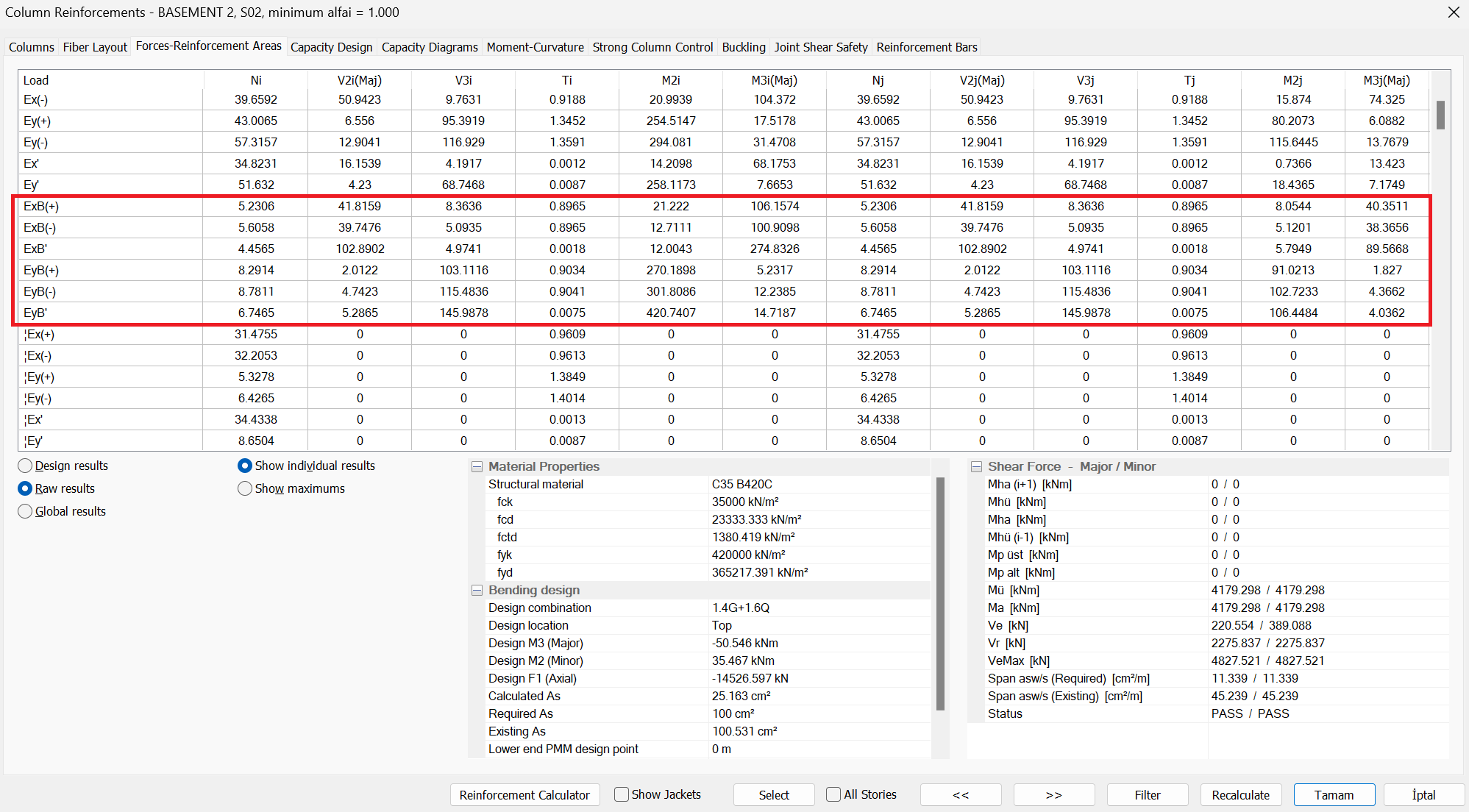

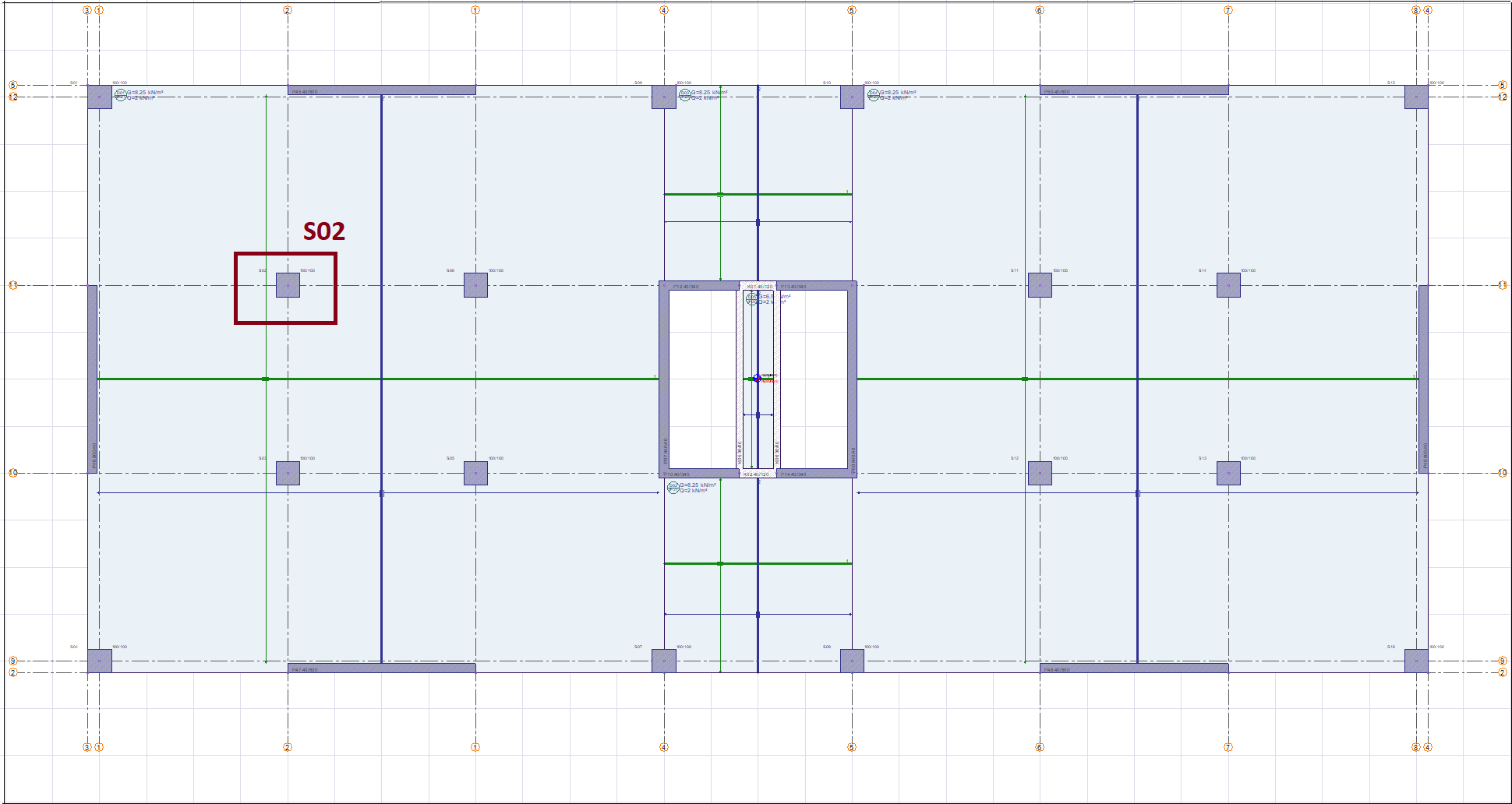

  • The second stage, the monolithic solution internal force results, are as follows. For example, the S02 column of the 2nd basement floor is used. In this column, which is a lower section element, the results of the first and second-stage cases will be used to determine the internal forces based on the design.
  • Results obtained from the solution where the upper and lower ends of the same column are hinged for the second stage.
  • It is seen that the shear force and moment values ​​are 0.
