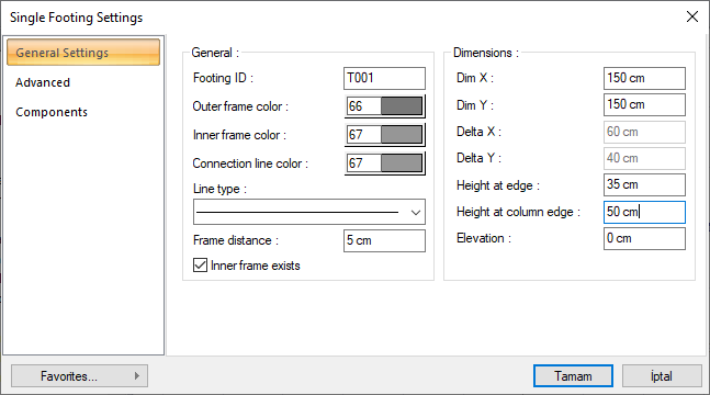

  1. Select single footing, single footings.
  2. Enter the properties.
  3. In the general settings tab, enter the appropriate size in the Dim X and Dim Y lines.
  4. You can change the thickness in the same place.
