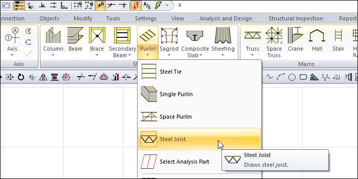

Location of Steel Joist Command
You can access it under the ribbon menu Steel tab, Steel heading.
  • Click the Steel Joist icon from the ribbon menu .

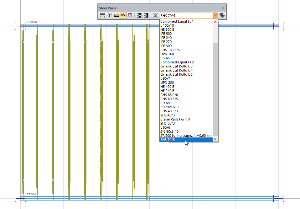

  • Select a profile from the list by clicking on the profile list in the steel purlin toolbar.

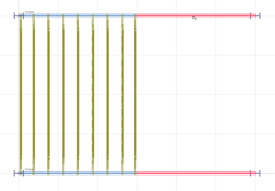

  • Choose the first of the steel beams or truss overhead heads that the steel joist will form between.

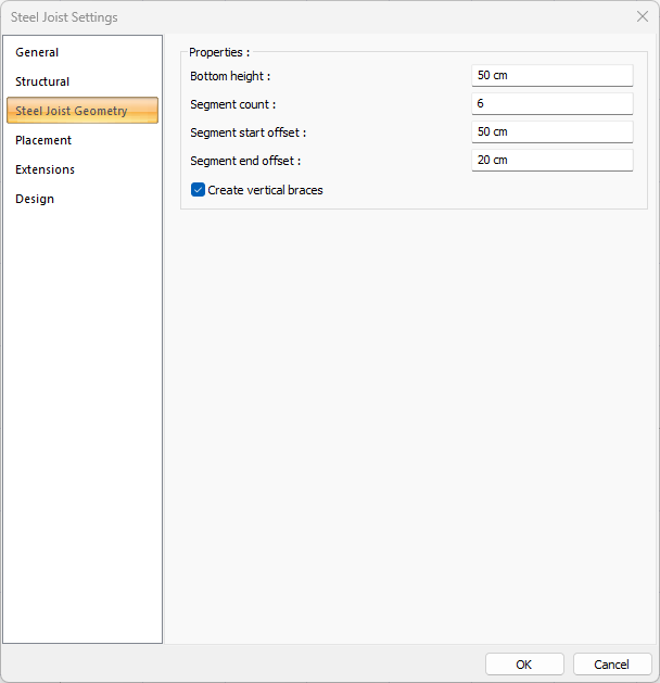

  • When you select your second steel beam or truss head, the Steel Joist Settings dialog will open.
  • In the dialog, there are parameters such as the height of the steel joist module, the number of joists, the layout, etc. After making the settings, click the OK button.

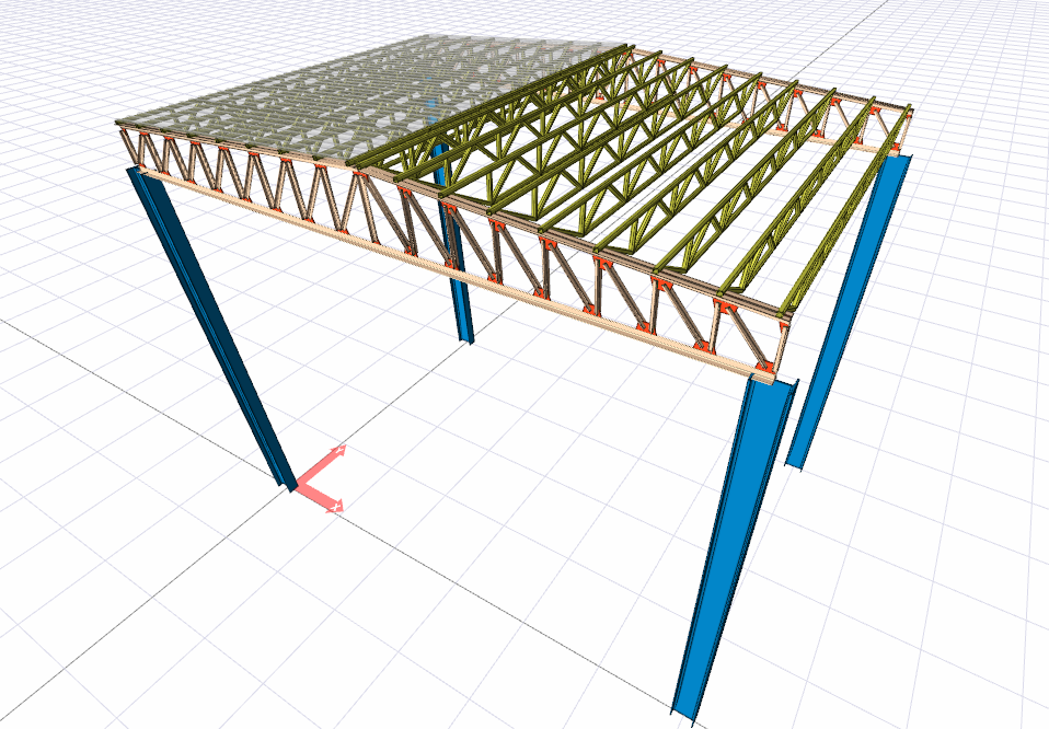

  • Steel joists will be formed.

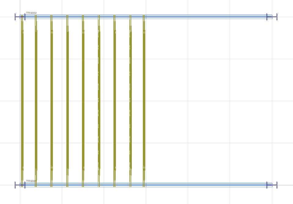

The area to be created in steel joist
Selecting a profile from the profile list
Choosing the first of the steel beams or truss upper heads to be formed between the steel joists

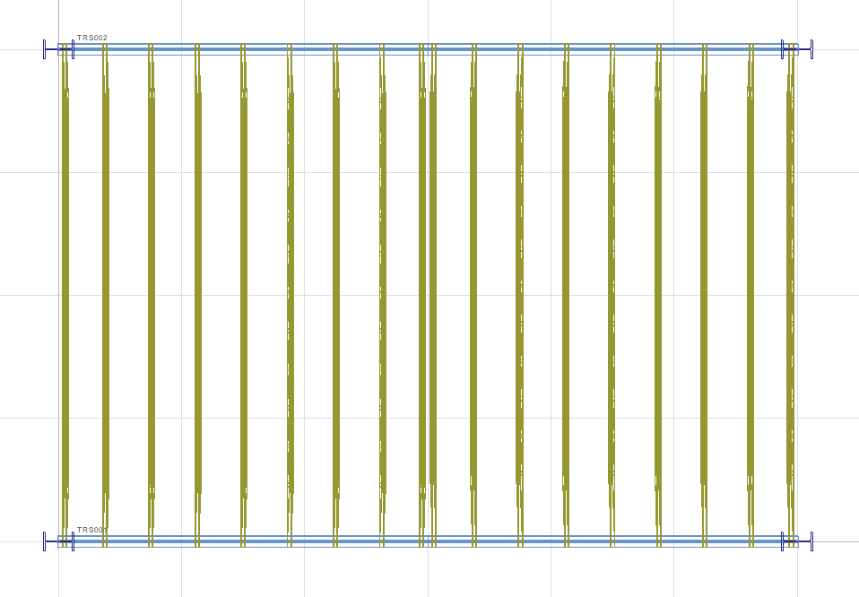

Choosing the second steel beam or truss head
Editing settings in the steel joist settings dialog
Formation of steel joists
