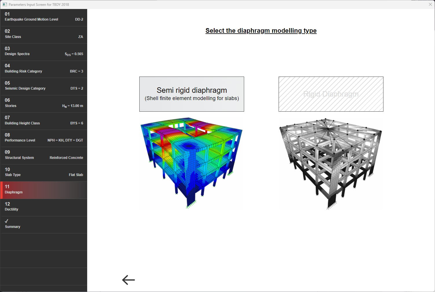

Solution:
Using the Analysis Settings / TBDY 2018 Analysis Settings Wizard , select the appropriate structural system, slab type and then select the semi-rigid diaphragm option.
