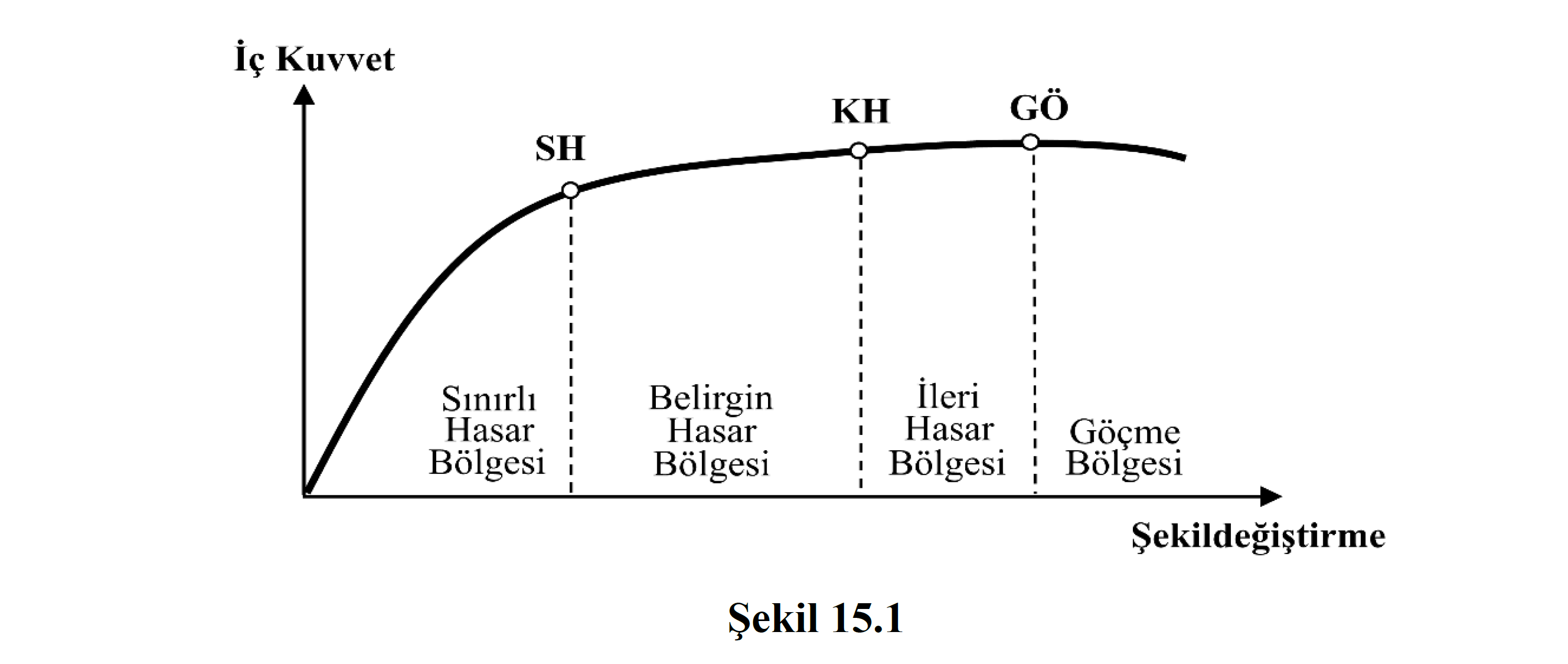

15.3.2. Section Damage Zones
Elements whose critical section damage does not reach SH are located in the Restricted Damage Zone , the elements between SH and KH are in the Significant Damage Zone , the elements between KH and PO are in the Advanced Damage Zone , and the elements exceeding the DE are in the Migration Zone . (Figure 15.1) .
15.3.3. Identification of Section and Element Damages
As a result of comparing the internal forces and / or deformations calculated by the methods defined in 15.5 or 15.6 with the numerical values ​​defined in 15.3.1 to correspond to the section damage limits, it will be decided in which damage regions the sections are. Element damage will be determined based on the most damaged section of the element.
