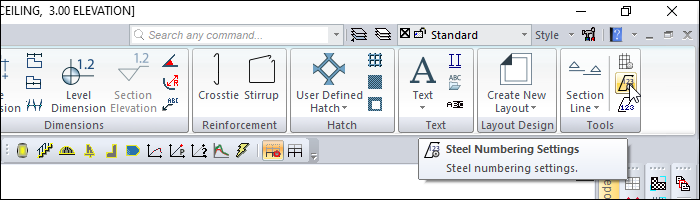

Group and pose similar parts of steel elements and details is performed using the Steel Numbering command. Before numbering, the starting numbers are determined according with the Steel Numbering Settings command.
Location of the Steel Numbering Settings Command
You can access it under the Drawings tab, Tools heading.

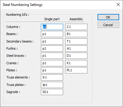

Columns
The position names to be given to the column elements in the single part and assembly drawings are written in the boxes.
Beams
In single part and assembly drawings, the names of the poses to be given to the beam elements are written in the boxes.
Secondary beams
The pose names to be given to the secondary beams in the single part and assembly drawings are written in the boxes.
Purlins
The names of the poses to be given to the purlin members in the single part and assembly drawings are written in the boxes.
Steel braces
In the single part and assembly drawings, the names of the pose given to the steel braces are written in the boxes.
Cranes
In the single part and assembly drawings, the names of the poses to be given to the cranes are written in the boxes.
Plates
In single part and assembly drawings, the names of the poses to be given to the plates are written in the boxes.
Truss elements
In the single part drawings, the names of the poses to be given to the trusses elements are written in the boxes.
Truss plates
In the single part drawings, the names of the poses to be given to the trusses plates are written in the boxes.
Sagrods
In the single part drawings, the names of the poses to be given to the sagrods are written in the boxes.

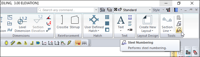

Location of the Steel Numbering Command
  • Click on the Steel Numbering command.
  • The program will start the numbering process.
  • When the numbering is complete, you can continue working.
