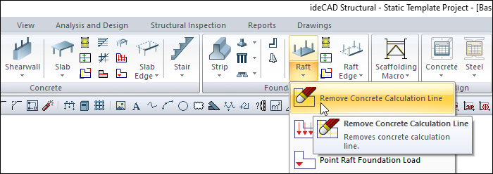

Location of Remove Concrete Calculation Line Command
You can find it in the ribbon menu under the Concrete tab, Foundation heading.
  • Click the remove concrete calculation line icon.
  • Move your mouse over the concrete calculation line you want to delete and click with the left button.
  • Concrete calculation line will be deleted.

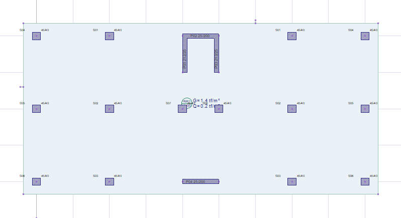

The raft foundation before the concrete calculation line is removed

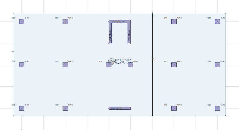

Selecting the concrete calculation line to be deleted

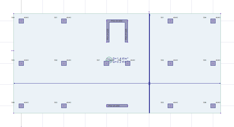

The raft foundation after the concrete calculation line is deleted
