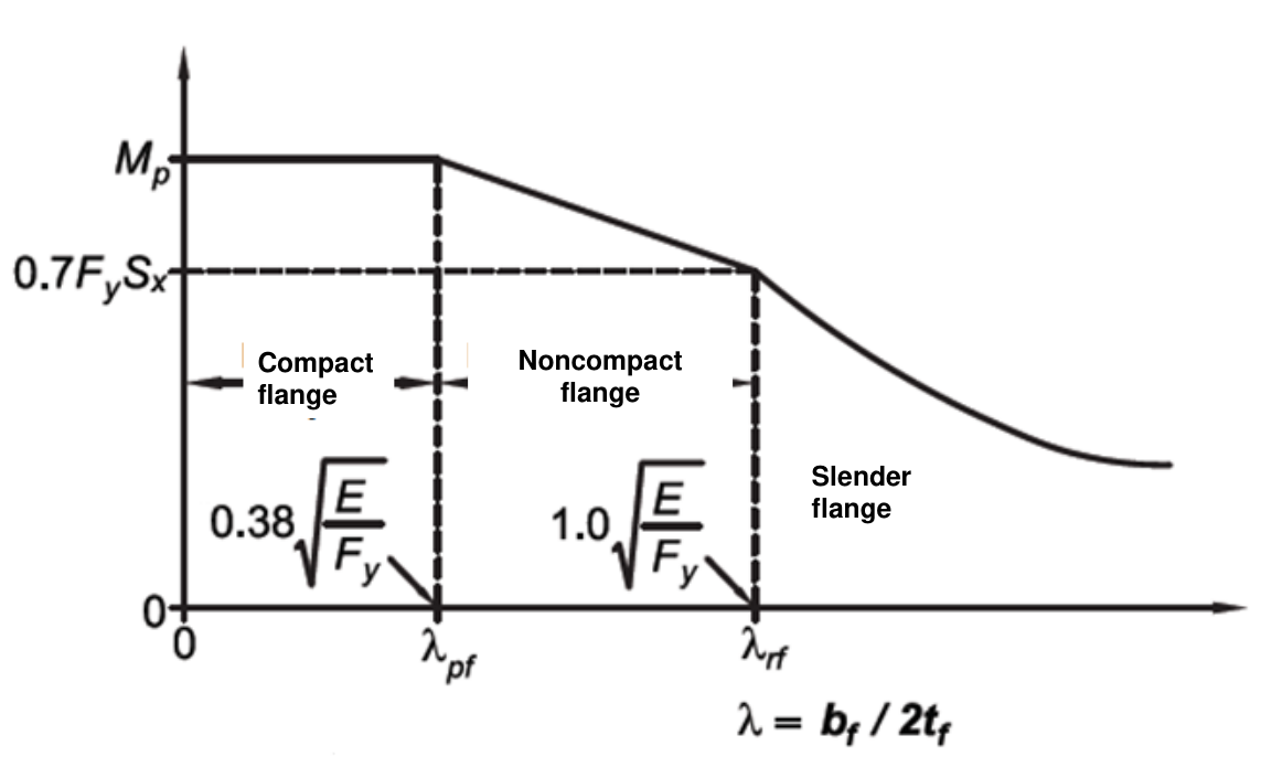

λp : Limiting slenderness for a compact flange, defined in Table B4.1b
λr : Limiting slenderness for a noncompact flange, defined in Table B4.1b
The nominal flexural strength, Mn, should be the lower value obtained according to the limit states of lateral-torsional buckling and compression flange local buckling.

Compression Flange Local Buckling Limit State
The nominal flexural strength, Mn, for sections with noncompact flanges;
The nominal flexural strength, Mn, for sections with slender flanges;
