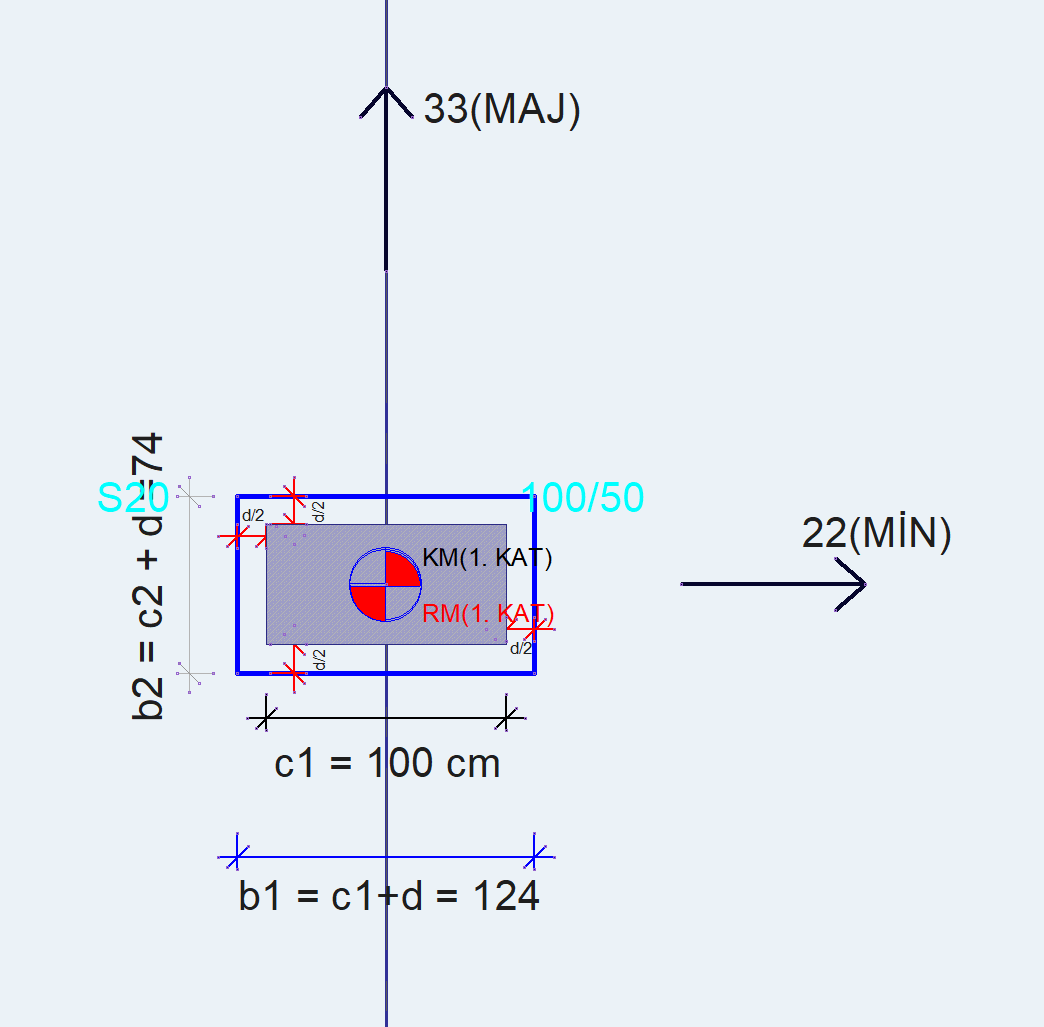

The punching circumference (up) is calculated at a distance d/2 from the column surface and is shown in the picture below. In this case, the following operations are performed to find the edges (b1, b2) of the punching.
In this case, the punching circumference, (up ), and the punching area (Az) obtained by multiplying the punching perimeter by the flooring useful height, d , is calculated as shown below.

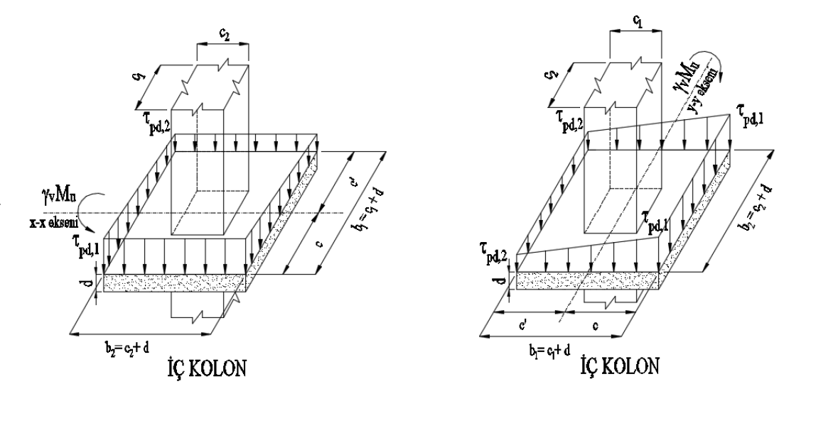

The shear stresses plotted below are the punching stresses perpendicular to the slab plane.
The J values ​​are the sum of the polar inertia and second moments of inertia of the surfaces forming the punching area (Az). According to TBDY Equation 7.28, this value is calculated according to the loading direction considering the γf coefficient .
