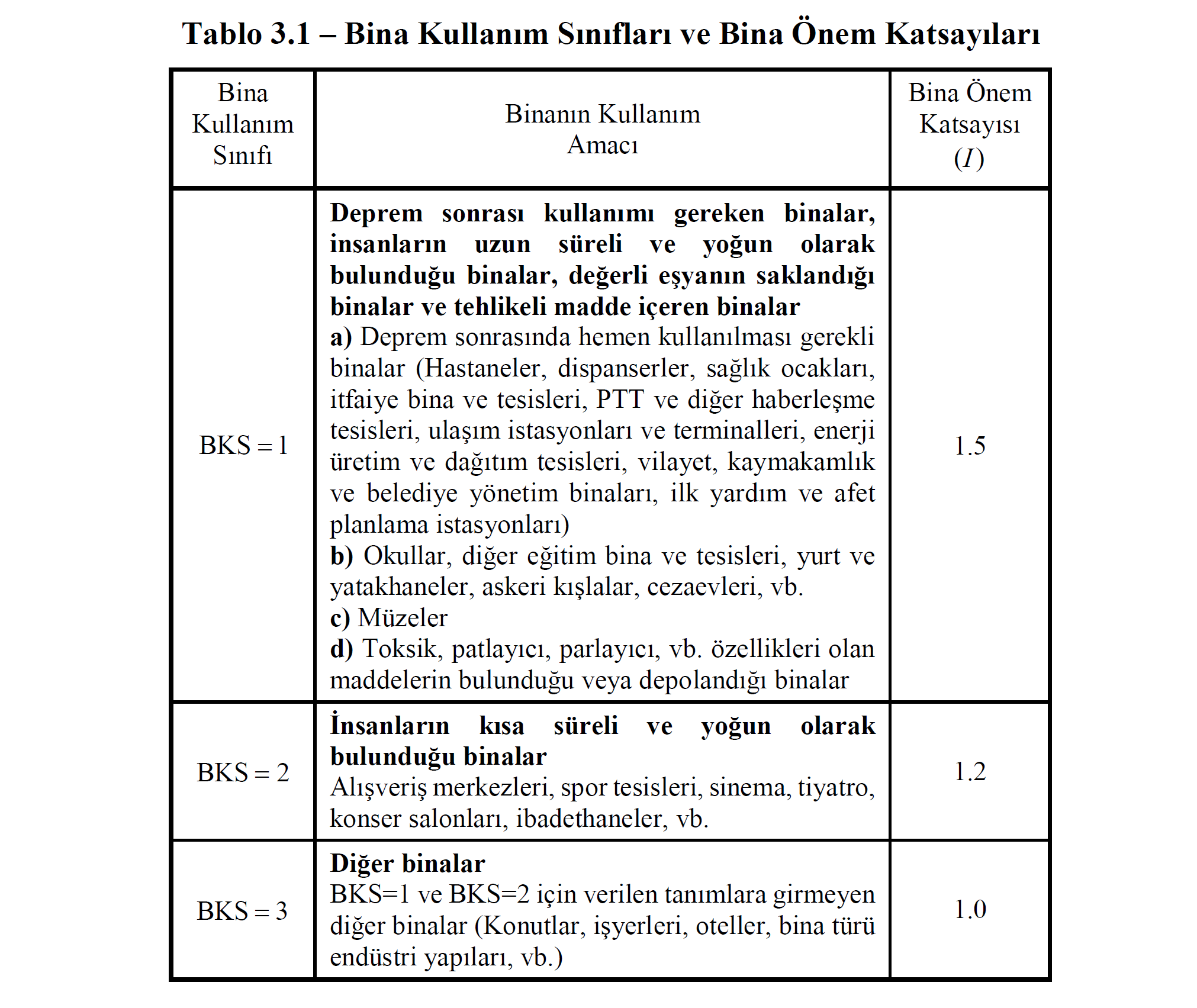

3.1. BUILDING USAGE CLASSES AND BUILDING IMPORTANCE FACTORS
3.1.1. Building Usage Classes
Building Use Classes (BKS) are defined in Table 3.1 depending on the intended use of the buildings, based on the determination of the Earthquake Design Classes defined in 3.2 .
