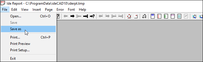

Location of Save As Command
You can access the Save As command from the File menu .
