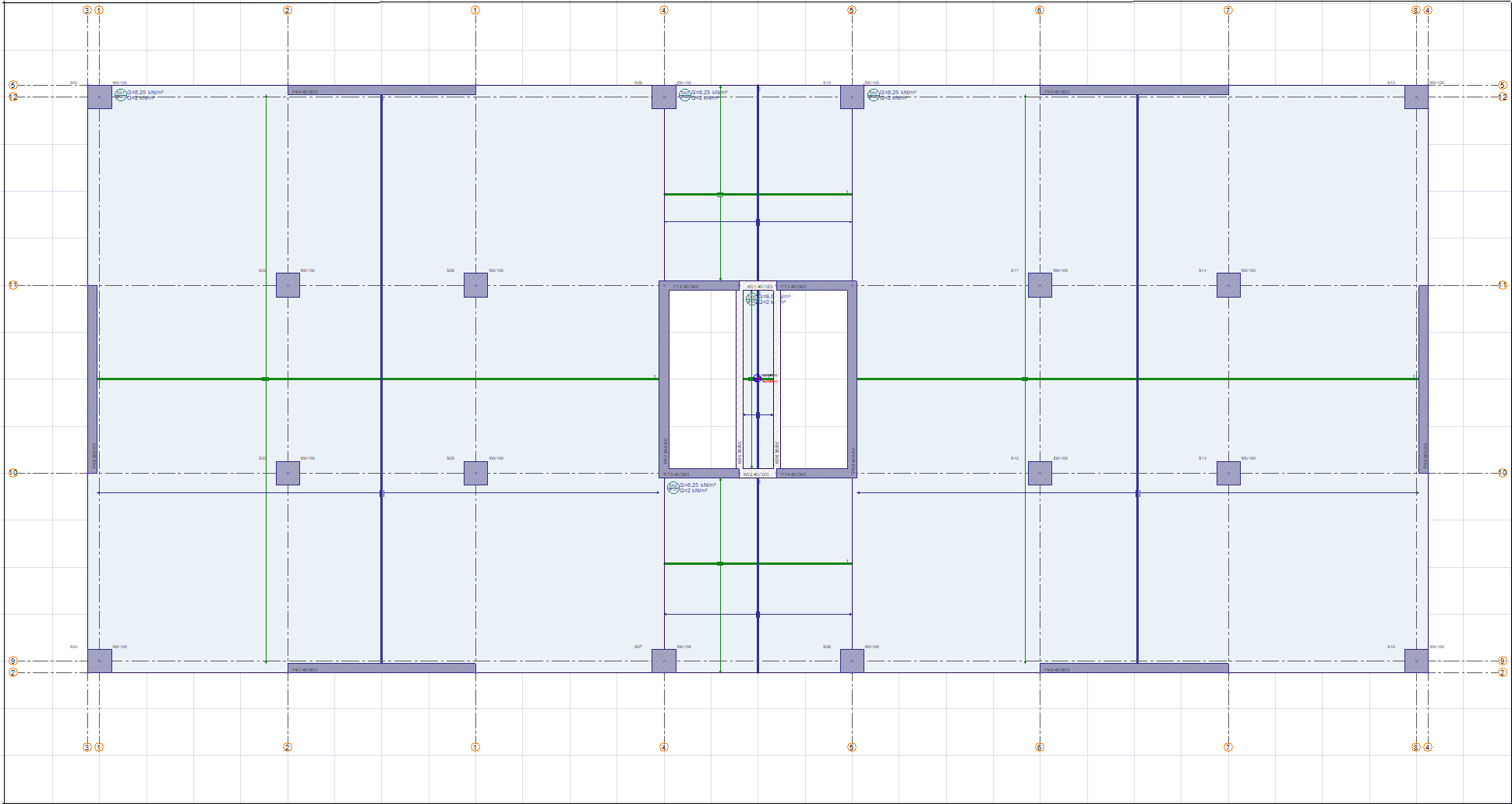

  • The building consists of 8 axes with 8 m span in the X direction and 4 axes with 8 m span in the Y direction.
  • The building is 56 m in total in X direction and 24 m in Y direction.

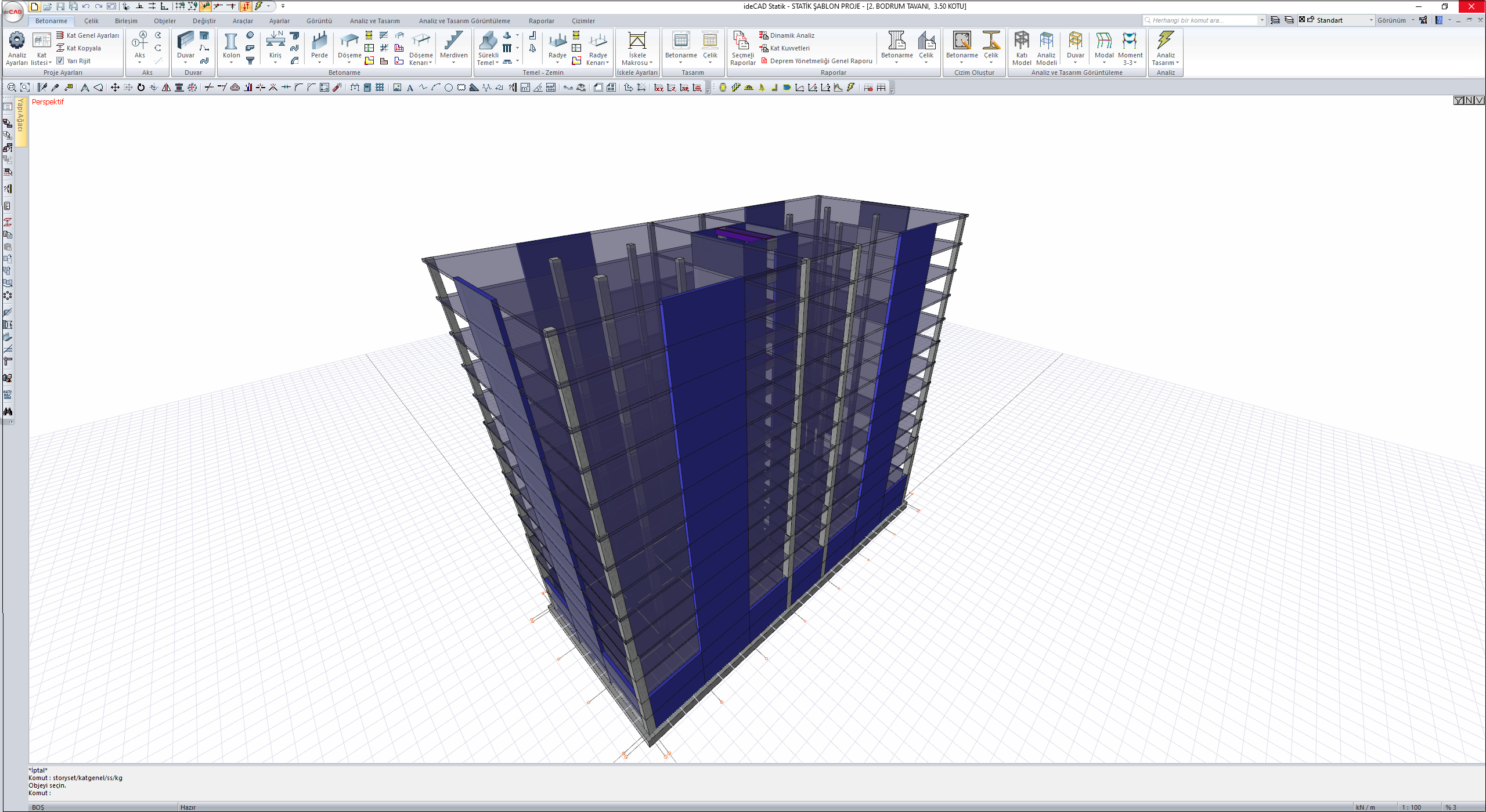

  • The building geometry is shown in the formwork plan and perspective view below.
  • It is foreseen that the load-bearing system of the building will be composed of high ductility shearwalls and flat slabs. In the middle of the building, two U-shaped shearwall groups were connected with coupling beams and a core shearwall was formed.
