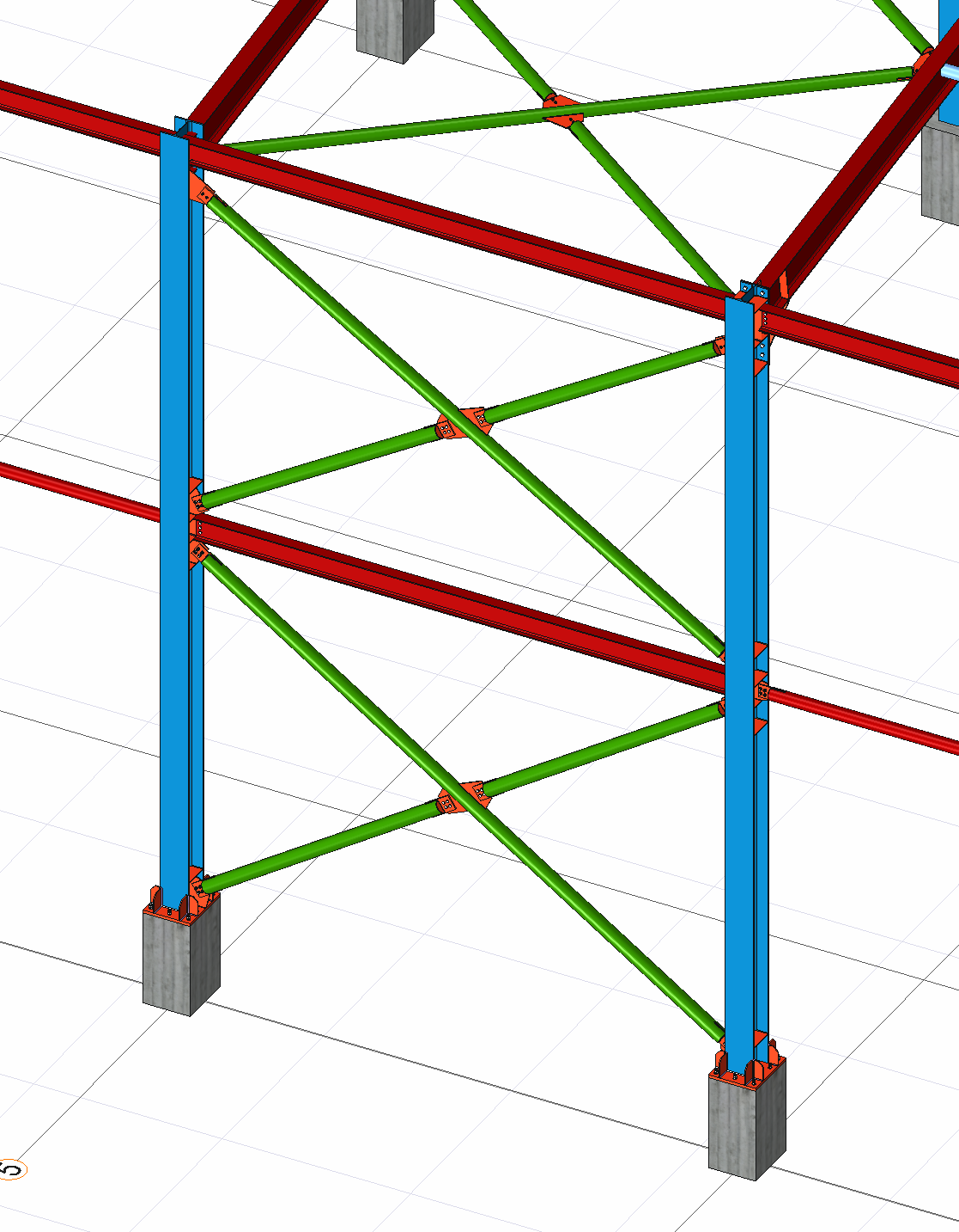

  • Laterally unbraced length of the steel element can be reduced by using steel braces.
  • The PMM ratio can be reduced if braces are entered to reduce the lateral retention length on the weak axis of the columns, as an example is shown in the picture below.
