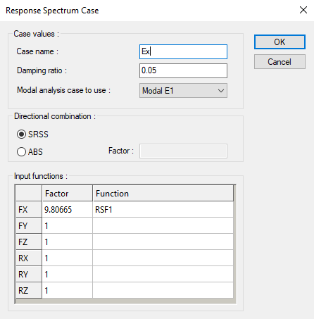

Design acceleration spectra used within the framework of design rules are automatically calculated according to the 5% damping ratio according to Codes.
If the designer want to change the damping ratio, it can be changed from response spectrum case tab.
