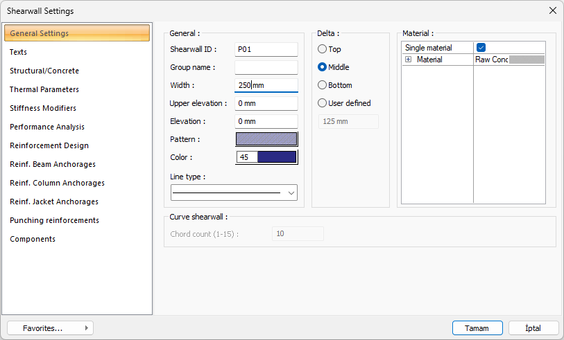

Solution:
If the height of the story will not change, increase the thickness of the shearwall with the name and the floor, not less than 250 mm until the requested condition is met.
Choose shearwall, shearwalls.
Enter the properties.
In the general settings tab, increase the shearwall width and click the OK button.
