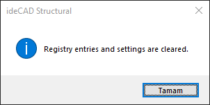

Solution 1
  • Hold down the Ctrl + Shift key on the left of the keyboard and run the program from the desktop shortcut.
  • Keep pressing the Ctrl + Shift keys until you get a message saying that registry entries and settings are cleared.
  • The message can stay in the background. Do not observe the message.
  • Continue the message by clicking OK. The program will open.
With this operation, the menu, toolbar and shortcuts are brought to the initial state of the program.

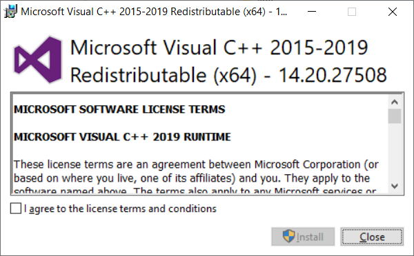

Solution 2
This can be caused by Microsoft Visual C ++ add-ins not being installed on the computer or incomplete installation
  • Click the links below to download the add-ons to your computer and run the installation.
Microsoft Visual C ++ 2015-2019 Redistributable Package (64 bit)
https://aka.ms/vs/16/release/vc_redist.x64.ex to
Microsoft Visual C ++ 2015-2019 Redistributable Package (32-bit)
https://aka.ms/vs/16/release/vc_redist.x86.ex to
  • During the installation, the following screen will appear. Click Install to complete the installation.
  • After the installation process is completed, you can run the ideCAD program.
