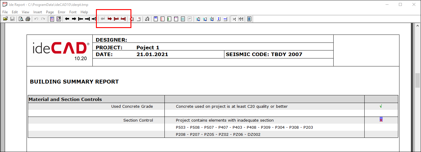

After receiving the report after Analysis+Design, if there are errors listed in the report in the project, the Project Errors menu or the "Error tracking shortcut keys (F5, F6, F7, F8)" are used to see the error in  order. This process applies to all account reports, including Select Reports
Usage steps:
  • After getting the report, use the error buttons or click the relevant line under the Project Errors menu.
  • Previous error: F5 key. Move the cursor to the previous error.
  • Next error: F6 key. Move the cursor to the next error.
  • First error: Move the cursor to F7 key. takes you to the location of the first error.
  • Last error: F8 key. Moves the cursor to the location of the last error.
