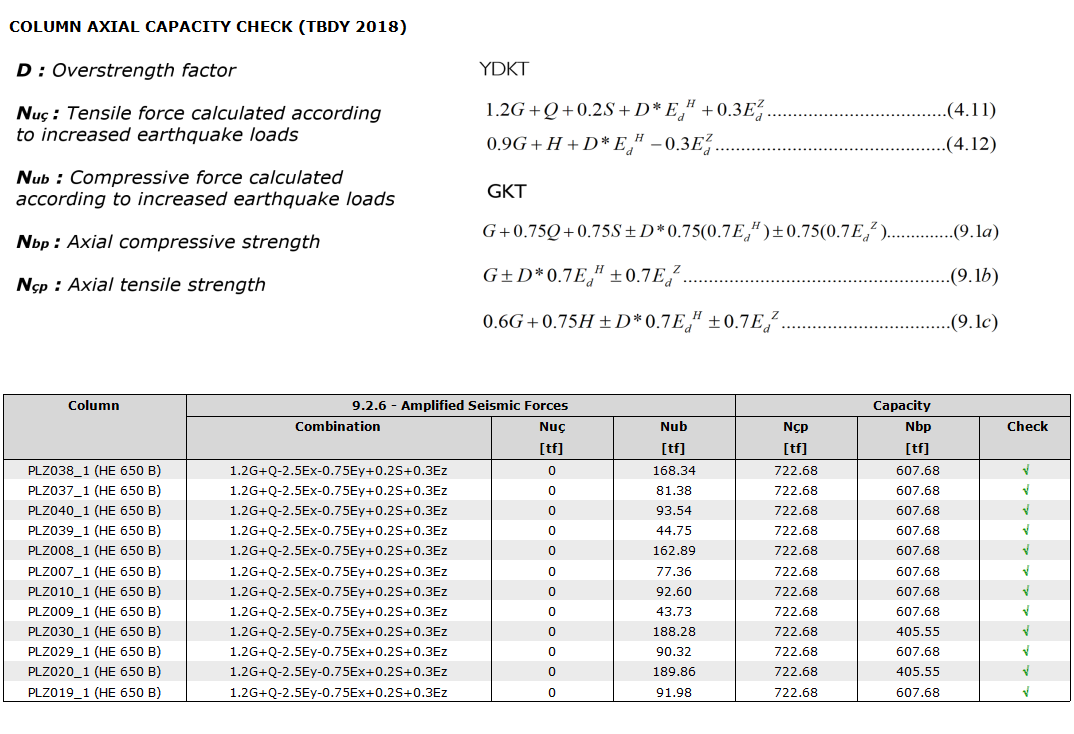

Columns, which are part of the frame members with high ductility level, are designed and reported under the tensile and compressive forces obtained by increasing them with overstrength factor D.
