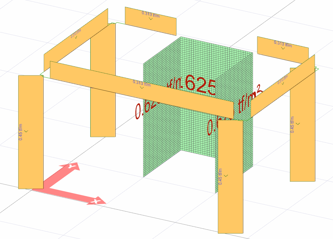

Self weight of column beams and curtains

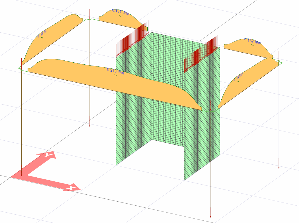

Constant (G) Loads transferred from slab to beams and bulkheads

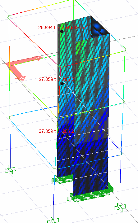

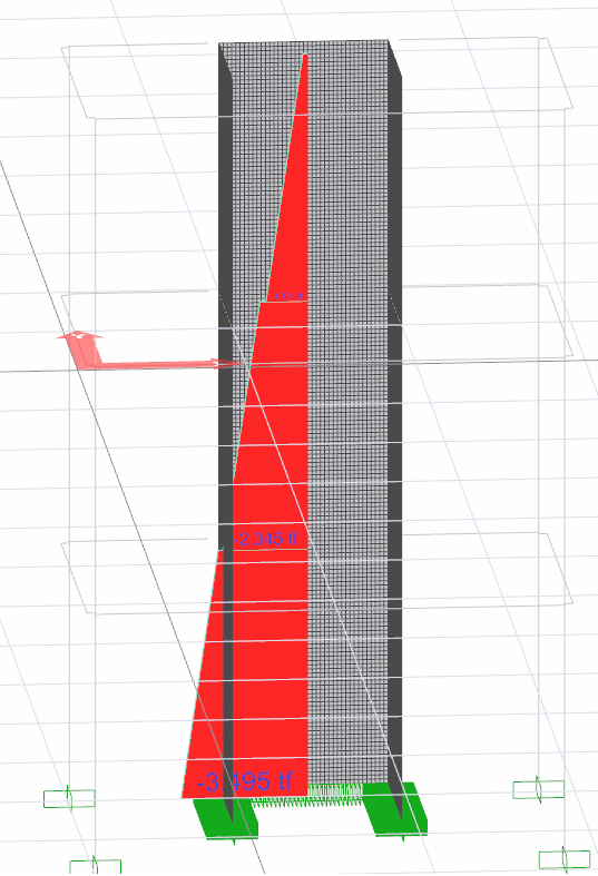

Lift curtain G loading Axial forces

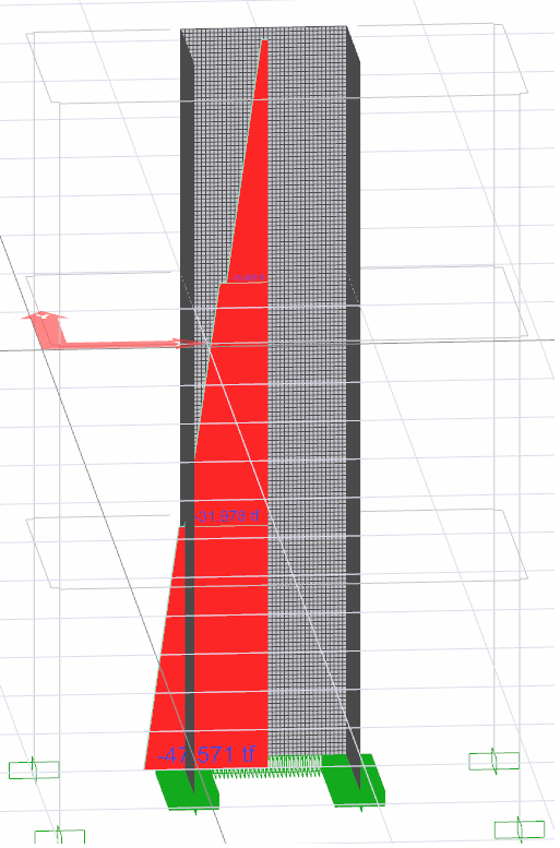

Lift curtain Q Loading Axial Forces

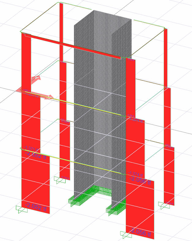

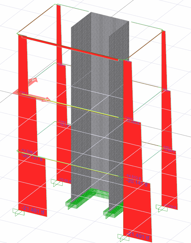

Axial forces of columns loading G

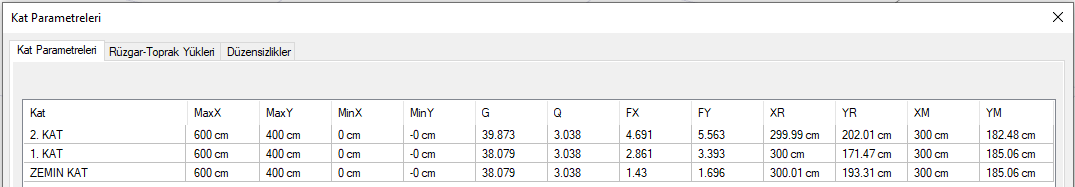

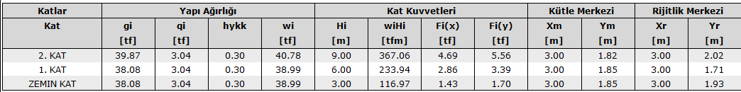

Floor G and Q loads shown in floor parameters
Floor weights printed on the Floor General Information report

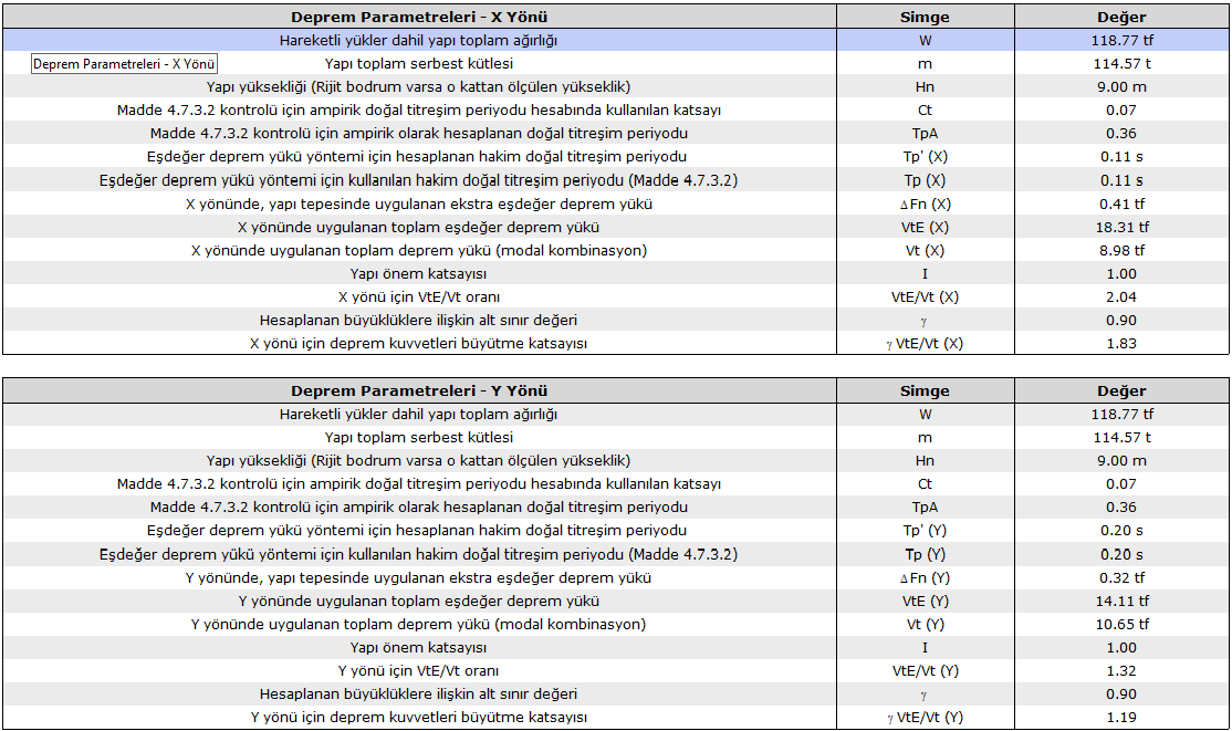

Building weight and free mass of the building printed in earthquake parameters in reports

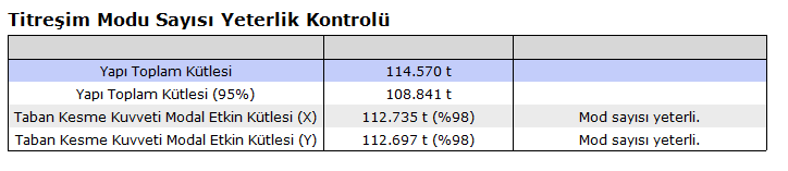

Build total mass printed in the Vibration Mode qualification check
