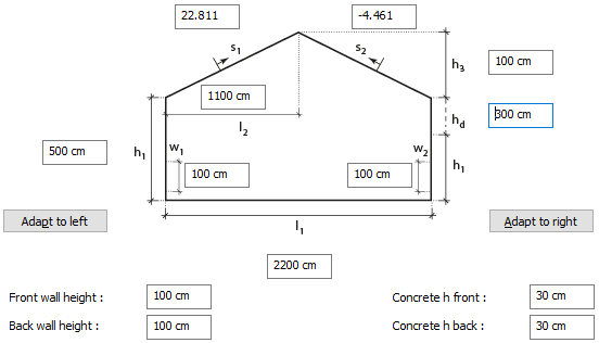

With the column height settings, the column heights are changed in the selected hall from the form settings section in the hall settings dialog.
Location of the Column Height Settings

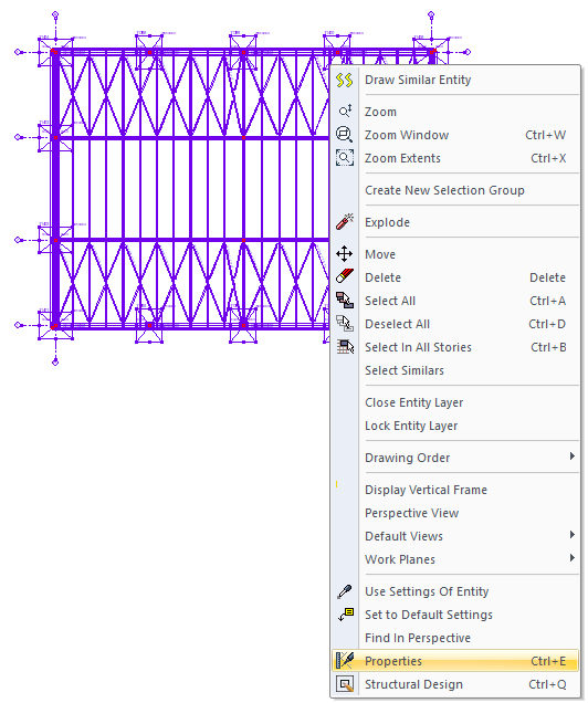

Select the hall where you want to change the column height and click the right mouse button. Click the Properties line from the right click menu that opens.

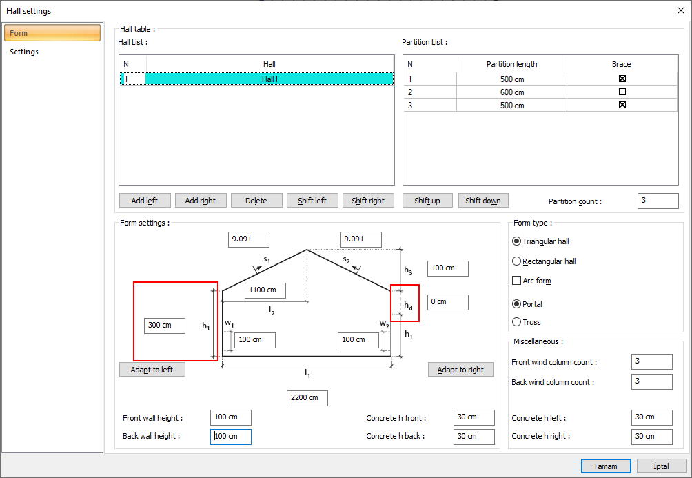

  • Enter the hall settings.

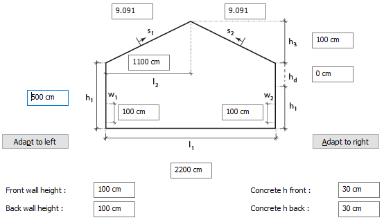

  • Enter the new height value in the h1 box.
  • If you do not want the hall to be symmetrical, value the height hd .
  • Your hall height will change according to the values ​​you entered.

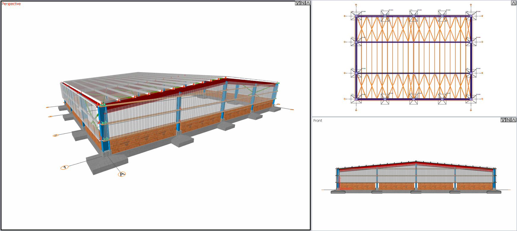

Hall view before changing the height

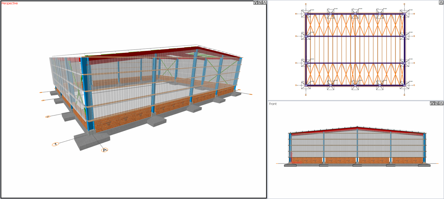

Hall view after h1 is changed to 500 cm

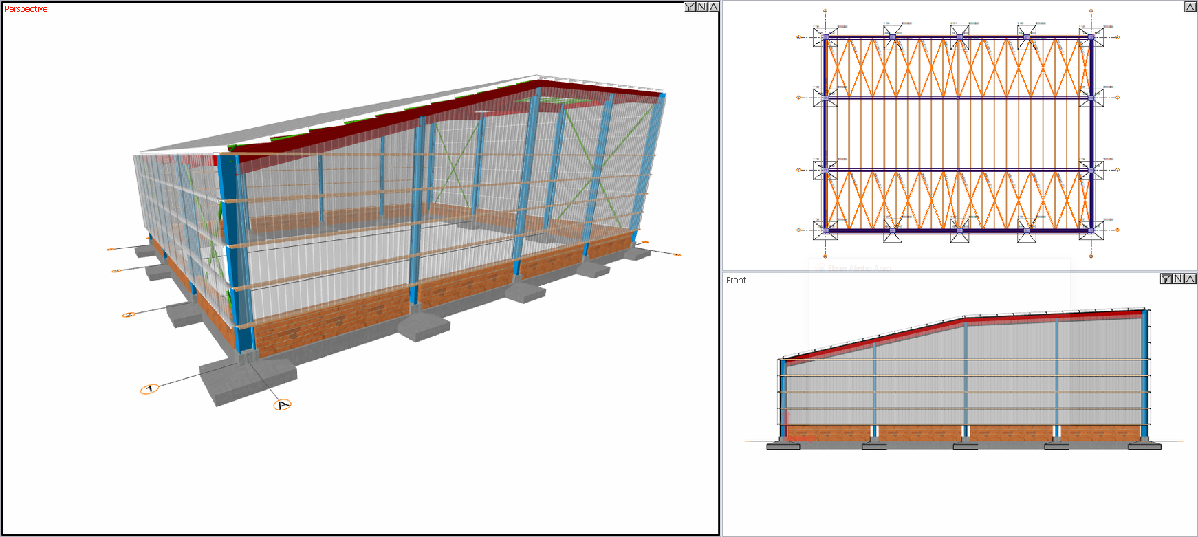

Hall view after changing h d to 300 cm
