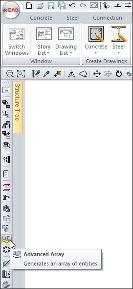

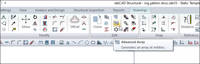

Location of the Advanced Array Command
Advanced Array command can be run from the toolbar on the left side of the program.
In addition, the Drawings tab is available under the Edit heading.

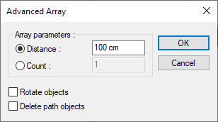

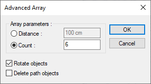

Advanced Array Dialog
Distance
If selected, objects are reproduced based on the range entered here. The distance between the base points of two duplicated objects is the distance entered in this box.
Count
If selected, objects are reproduced based on the number entered here. This number of objects are placed at equal intervals on the reproduction line.
Rotate objects
If checked, the duplicated objects will be rotated due to slope changes in the pattern line.
Delete path objects
If checked, the reference pattern line is deleted after objects have been duplicated. If not checked, the propagation line is not deleted.

  • Click the Advanced Array icon on the left toolbar.

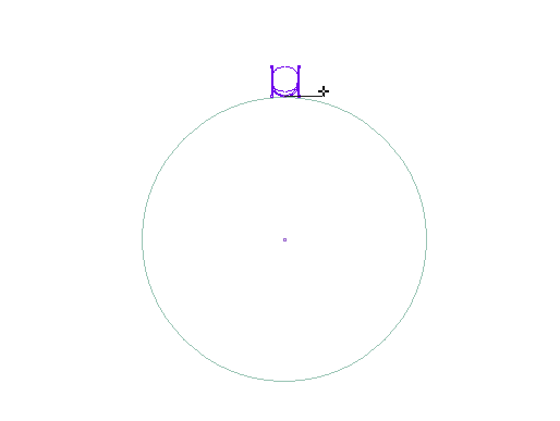

  • Select the object or objects you want to duplicate in the drawing area by clicking with the left mouse button, then click the right mouse button.
  • Click with the left mouse button to give the base point. (The base point can be any point or it is usually given as one of the object nodes. Objects are reproduced based on this point. Base points are located on the reproduction line.)

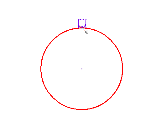

  • Select the object or objects (line, circle, arc, etc.) that make up the pattern line by clicking with the left mouse button.
  • Click the right mouse button after the selection is completed. The Advanced Array dialog will be displayed.

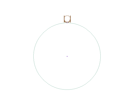

Selecting the object to be duplicated

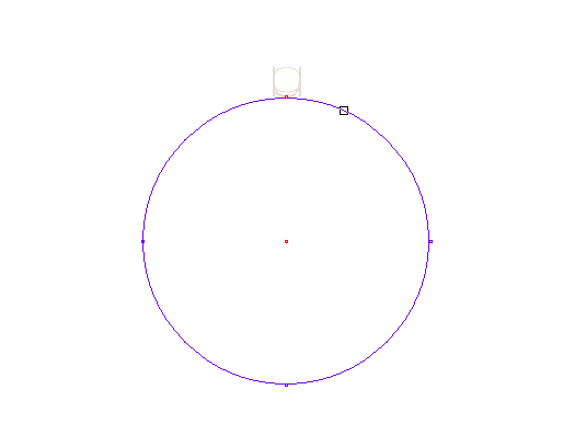

Determination of the base point on the reproduction line
Determining the direction of the base
Selection of the reproduction line
Making the settings

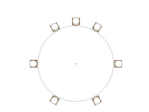

Reproduction of the object

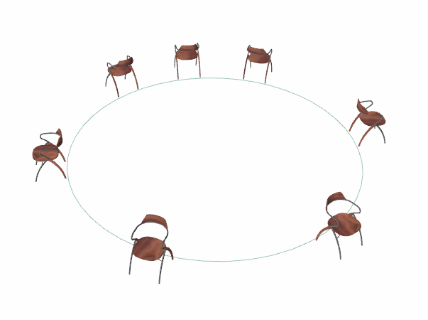

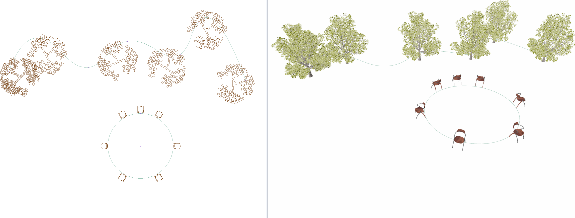

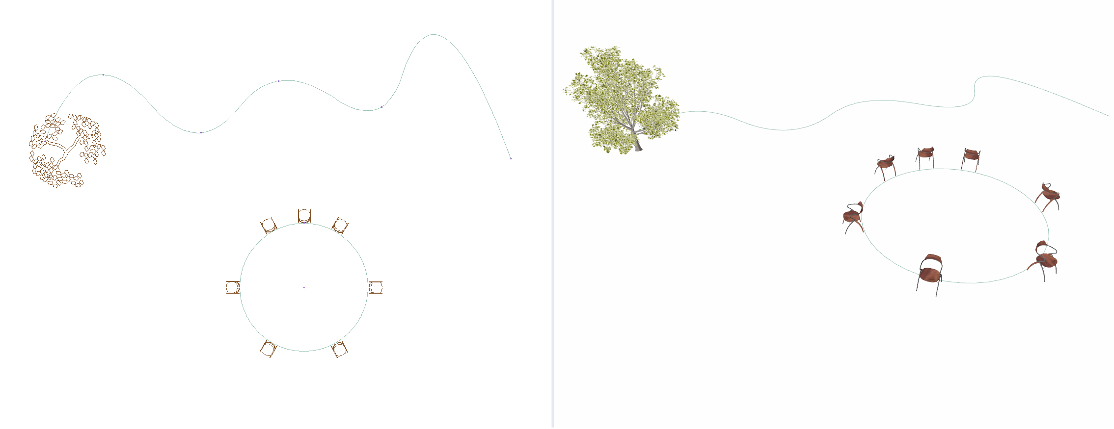

Advanced array example
Before advanced array
After advanced array
