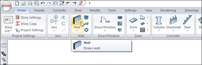

  • Click the Wall icon from the ribbon menu .
  • The wall toolbar will open. Click on the Break from toolbar icon.

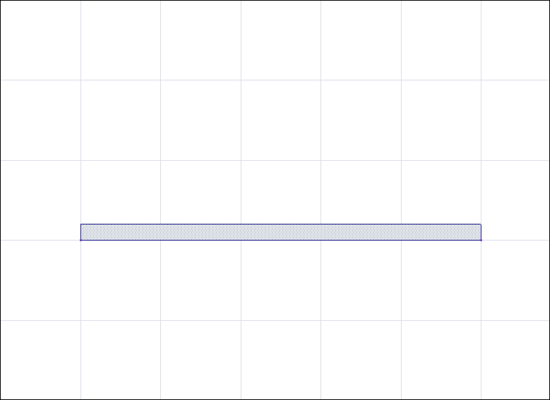

Before the break command

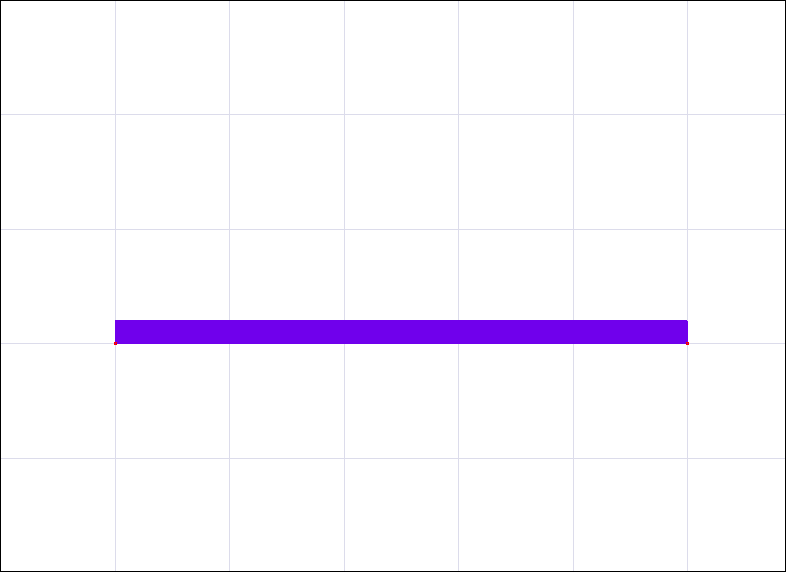

Choosing the wall to be divided

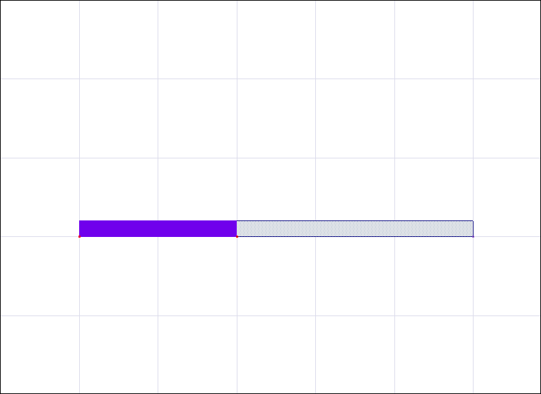

Determining the dividing point
Division of the wall

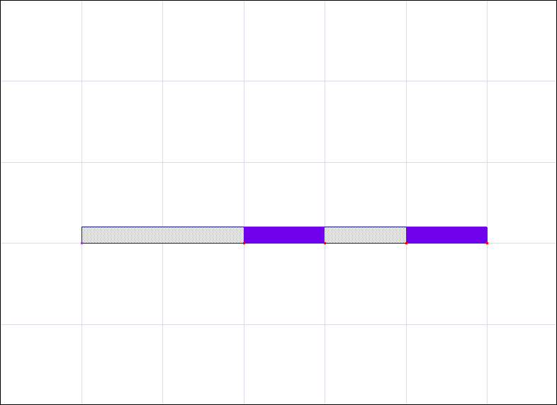

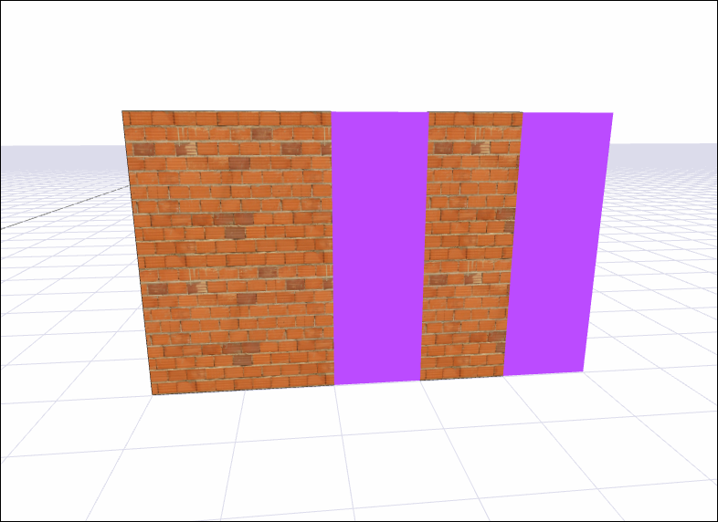

Dividing the wall into four parts
