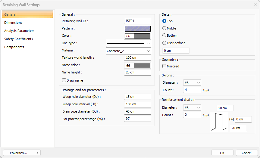

Retaining wall ID
Enter the name of the retaining wall that will appear in the meter and report.
Pattern
Select the color and hatch type of the retaining wall from the window that opens when clicked.
Line type
The line type of the line forming the retaining wall is selected in the plan. Clicking the down arrow buttons to the right of the boxes opens the list of line types. From this list, the desired line type is selected by clicking with the left mouse button.
The material to be covered on the retaining wall in the solid model is selected. The retaining wall is covered with the selected material and displayed in the solid model like this.
Texture world length
Texture length is entered. For example; If 1 unit is entered, the selected material texture width is taken as 1 unit and covered on the selected object. Considering that the texture is in the form of a square, the object surfaces are covered with 1x1 textures arranged side by side.
Name color
The name color of the retaining wall visible on the plan is selected. When the color box is clicked, the appropriate color is selected from the window that opens.
Name height
The name height of the retaining wall visible on the plan is selected.
Draw name
If checked, the name of the retaining wall appears on the drawing screen.

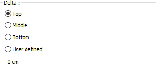

Delta
These are the options that determine where the retaining wall will be defined. If the virtual axis joining the nodes at the two ends of the retaining wall will coincide with the upper edge of the retaining wall, top is marked, if it coincides with the lower edge, bottom option is marked, and the middle option is marked if it will pass through the middle. If the virtual beam axis will pass through another line, user defined option is checked and the distance to the upper edge of the retaining wall is entered in the lower data entry box.
Mirrored
It takes the mirrored of the retaining wall according to its axis.

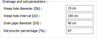

Drainage and soil parameters
In the retaining wall drawings, you can edit the diameters of the weep hole and drain pipe to be shown on the wall, and the soil proctor percentage information of the backfill ground in this section.
S-irons
Diameter and count of s-irons are determined

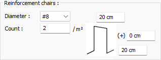

Reinforcement chairs
You can arrange the diameter, dimensions of the reinforcement chairs to be used on the foundation of the retaining wall and how many will be used per square meter from this section.

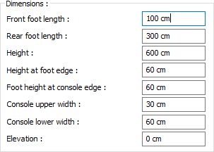

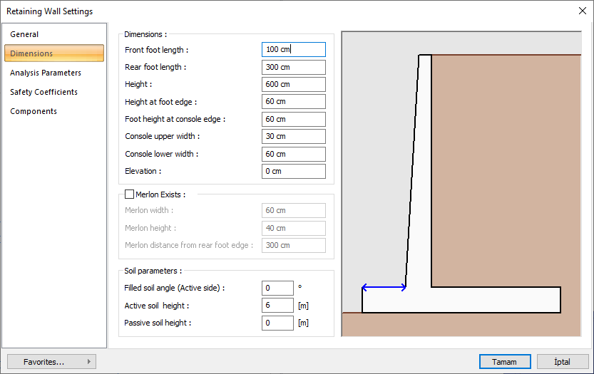

Dimensions Tab
Dimensions
Dimensions are given to the program according to the drawing shown in the dialog.
Merlon exists
If there will be merlon, the option is selected and merlon dimensions are entered.
Soil parameters
Adjust the heights of the soil on the active and passive side. You can also define the angle that the soil on the active side makes with the retaining wall. Adjust the heights of the soil on the active and passive side. You can also define the angle that the soil on the active side makes with the retaining wall. You can instantly watch the changes you have made in the drawing on the right.

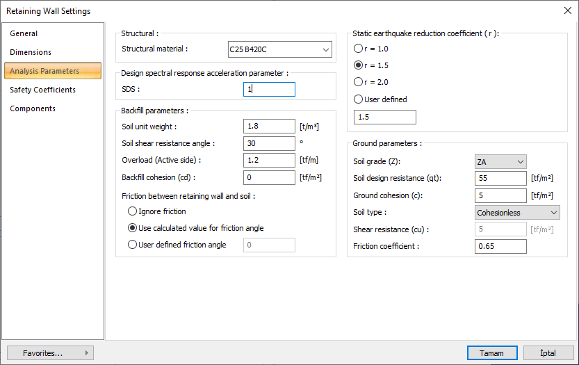

Analysis Parameters Tab
Structural material
Select the structural material to be used in the retaining wall calculation and reinforced concrete from the list.
Design spectral response acceleration parameter
Enter the predicted SDS value for the retaining wall according to TBDY 2018.

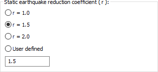

Static earthquake reduction coefficient (r)
According to TBDY 2018 Table 16.7, the r coefficient to be used in the calculation of soil pressures is selected.
Soil unit weight
Enter the unit weight of the soil to be used as backfill.
Soil shear resistance angle
Enter the soil shear resistance angle value according to the type of backfill soil.
Overload (Active side)
If available, enter the overload value on the active side.
Backfill cohesion (cd)
Enter the cohesion value of the backfill soil.
Friction between retaining wall and soil
You can neglect the friction, use the calculated friction value, or enter your calculated friction angle value.
Soil grade
You can select the ground class according to TBDY 2018 from the list.
Soil design resistance (qt)
The basic bearing strength for TBDY 2018 is the design strength (q t ). It is determined according to the soil report. The basic bearing strength design strength q t is the ratio of the soil characteristic strength q k to the strength coefficient value of 1.4. (TBDY 2018 Article 16.8.2)

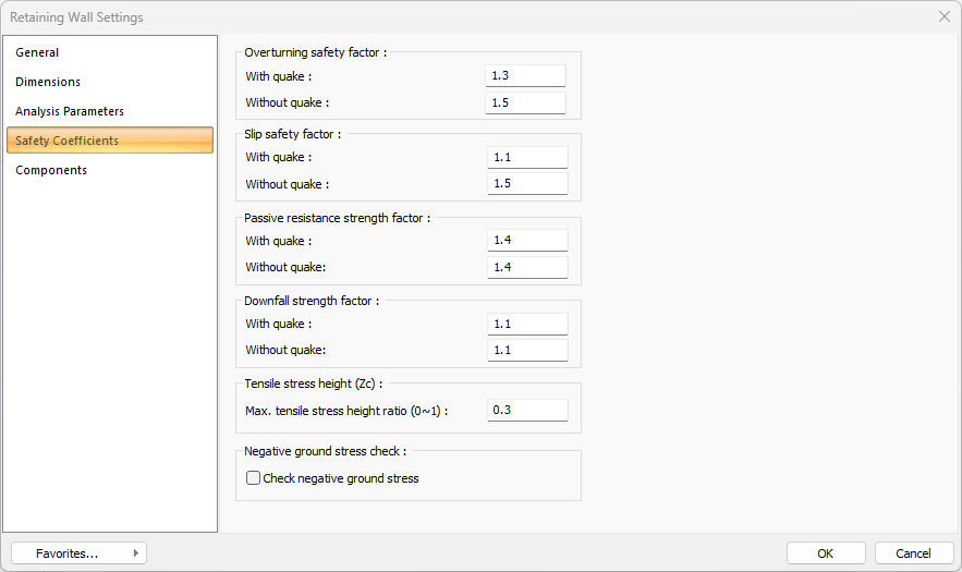

Safety Coefficients Tab
Overturning safety factor
The factors to be used in the overturning safety calculations are determined from the relevant boxes for earthquake and non-earthquake situations.
Slip safety factor
The factors to be used in slip safety calculations are determined from the relevant boxes for seismic and non-seismic conditions.
Passive resistance strength factor
The factors to be used in the passive resistance strength safety calculations are determined from the relevant boxes for earthquake and non-earthquake situations.
Downfall strength factor
The factors to be used in the downfall strength safety calculations are determined from the relevant boxes for earthquake and non-earthquake situations.
Tensile stress height
The maximum value of the tensile stress height ratio that is expected to occur from the top soil level down in clayey soils is determined here.
Negative ground stress check
As a result of the foundation analysis, negative soil stresses may occur. If this option is selected, if there is a fundamental negative stress, the program will give a message of negativity at the end of the calculation.

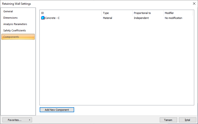

Components Tab
Add Building Components : Assigns the building materials defined for detailed building components metrics to the object.
In the usage section
The lines that appear in the Proportion list according to the ladder object and material size are as follows:
Retaining wall
Measure
Listed
Explanation
Constant
Independent
Length
Independent
Area
Independent
The area measure found when defining the material will be used exactly as the area of ​​the material.
Volume
Independent
Volume
Count
Independent
