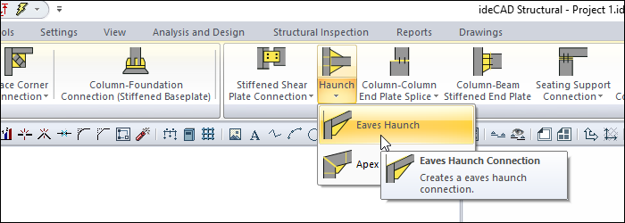

Location of the Eaves Haunch Connection Command
You can access it under the Ribbon menu, Connection tab, Experimentals title.
If Draw in Fast Mode is Active
  • From the Connection menu, click on the Eaves Haunch Connection icon.

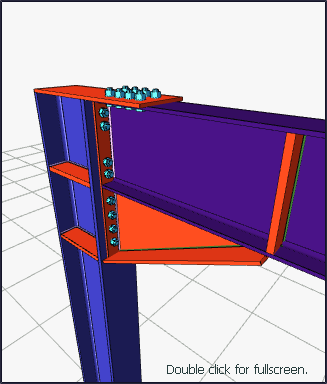

  • In 3D perspective view, move the mouse pointer closer to the element, close to the support
  • After this process, the virtual image of the connection will appear.
  • If the connection is suitable, create the connection by clicking the left mouse button.
  • The connection will occur with default settings.

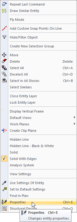

If the draw in fast mode is inactive, select the connection and click the right mouse button. Click the Properties line from the right-click menu that opens.

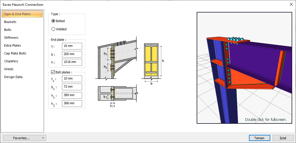

Eaves Haunch Connection Settings Dialog
Type and End Plates Tab
Type
For the connection, one of the bolted or welded connection types is selected.
End plate
The end plate is determined by entering the values. The values ​​to be entered are shown in the schematic drawing.
Bolt plates
Bolt plates are determined by entering values. The values ​​to be entered are shown in the schematic drawing.
Schematic drawing
Connection and plate values ​​are shown on the schematic drawing.
Preview
There is a preview of the connection. The selection made and the entered values ​​can be followed simultaneously in the preview.

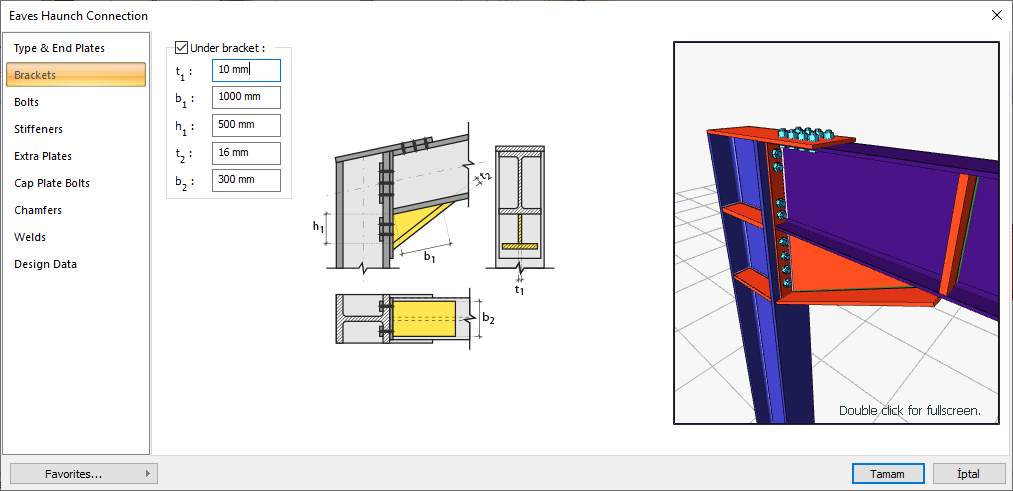

Brackets Tab
Under bracket
It is determined by entering the values ​​for the under bracket. The values ​​to be entered are shown in the schematic drawing.
Schematic drawing
Preview

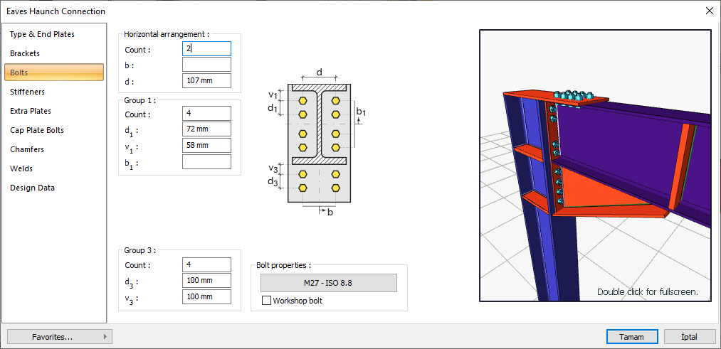

Bolts Tab
Horizontal arrangement
The horizontal arrangement distance value of the bolts is entered. The values ​​to be entered are shown in the schematic drawing.
Group 1
Distance values ​​of bolts to beam and other bolts are entered. The values ​​to be entered are shown in the schematic drawing.
Group 3
Bolt properties
The Hole and Bolt Parameters dialog is opened by clicking on the bolt properties button. The bolt properties are set in this dialog.
Schematic drawing
Connection and bolt arrangement values ​​are shown on the schematic drawing.
Preview

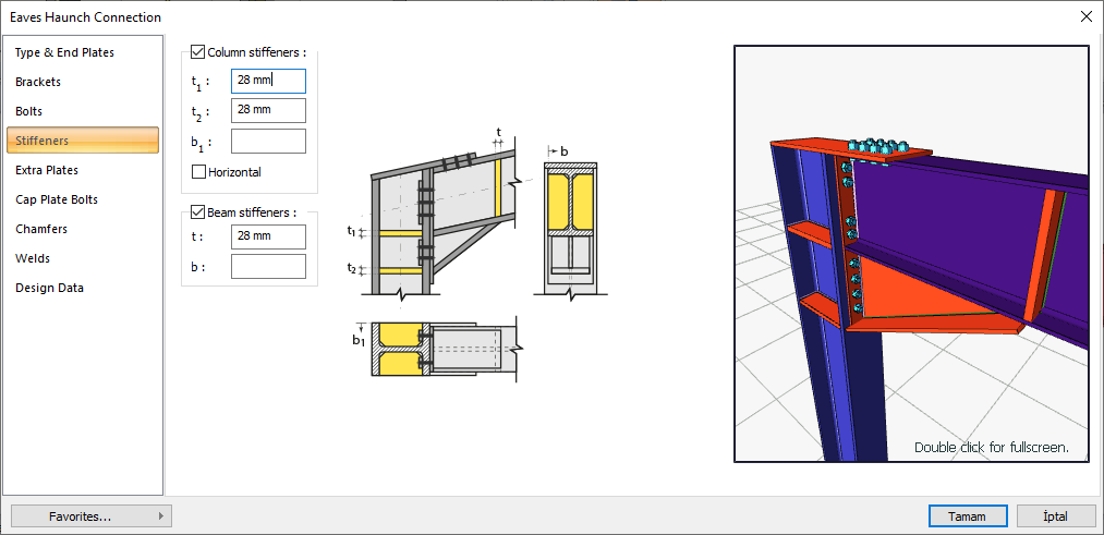

Stiffeners Tab
Column stiffeners
Column stiffeners are determined by entering values. The values ​​to be entered are shown in the schematic drawing.
Beam stiffeners
Beam stiffeners are determined by entering values. The values ​​to be entered are shown in the schematic drawing.
Schematic drawing
Preview

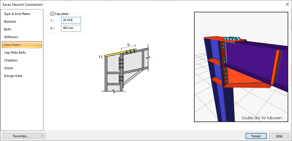

Extra Plates Tab
Cap plate
Top plate is determined by entering values. The values ​​to be entered are shown in the schematic drawing.
Schematic drawing
Preview

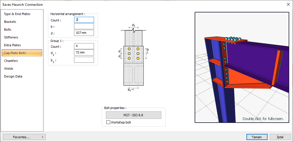

Cap Plate Bolts Tab
Group 1
Bolt properties
Schematic drawing
Preview

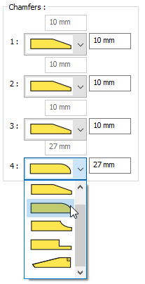

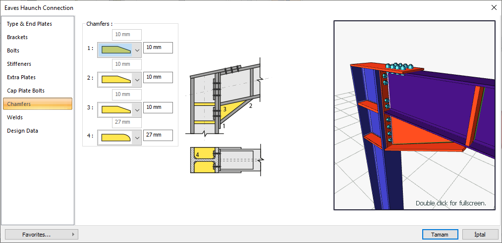

Chamfers Tab
Chamfers
For easy assembly of the plates in the field, the use of slope, slope type and geometric properties are determined by entering the value.
Schematic drawing
Connection, notching and cutting values ​​are shown on the schematic drawing.
Preview

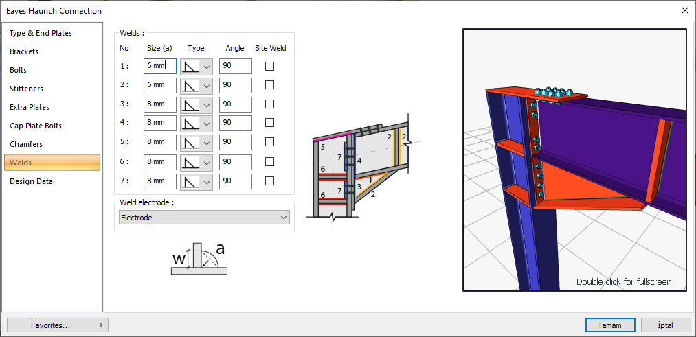

Welds Tab

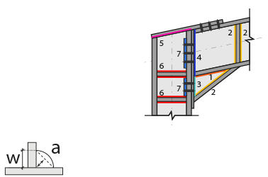

Welds
The thickness, type and angle values ​​of the welds to be made at the connections are given. The information on whether it will be done on the construction site or not is entered.
Weld electrode
The strengths of the welding electrodes are defined in the design inputs. The strength of the main element in the weld connection is controlled under the condition that it has less strength than the weld strength.
To create the welding electrode, provide the information "Name" and "Weld metal tensile strength" in the dialog that opens after clicking "Create New".
Welding geometry is determined automatically by the program. These properties can be changed to easily determine the connection properties. Geometry features are in accordance with industry standards and in the form specified in AISC.
720fef17-ac1d-4a5d-86b4-41401a12b14e#media-blob-url=true&id=d49c9cad-a504-4a4d-b67f-2d9f4a47838d&contextId=35749&collection=
Schematic drawing
Connection and weld values ​​are shown on the schematic drawing.
Preview

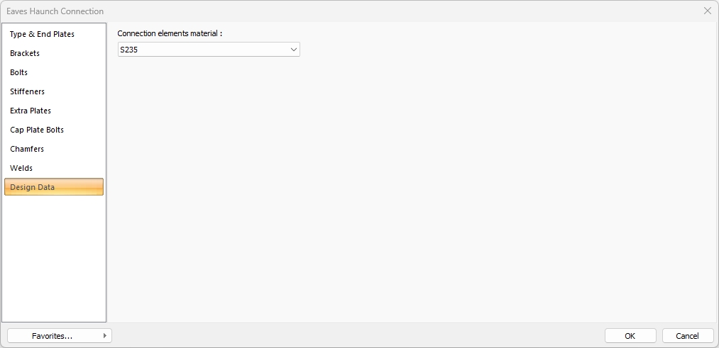

Design Data Tab
In the design data, the connection elements material is defined. The condition that the main element in the weld joint has less strength than the weld strength is controlled.
If necessary, click the list and define "Create New…". To create the connection elements material, give the information material definitions and values in the dialog that opens after clicking "Create New".
