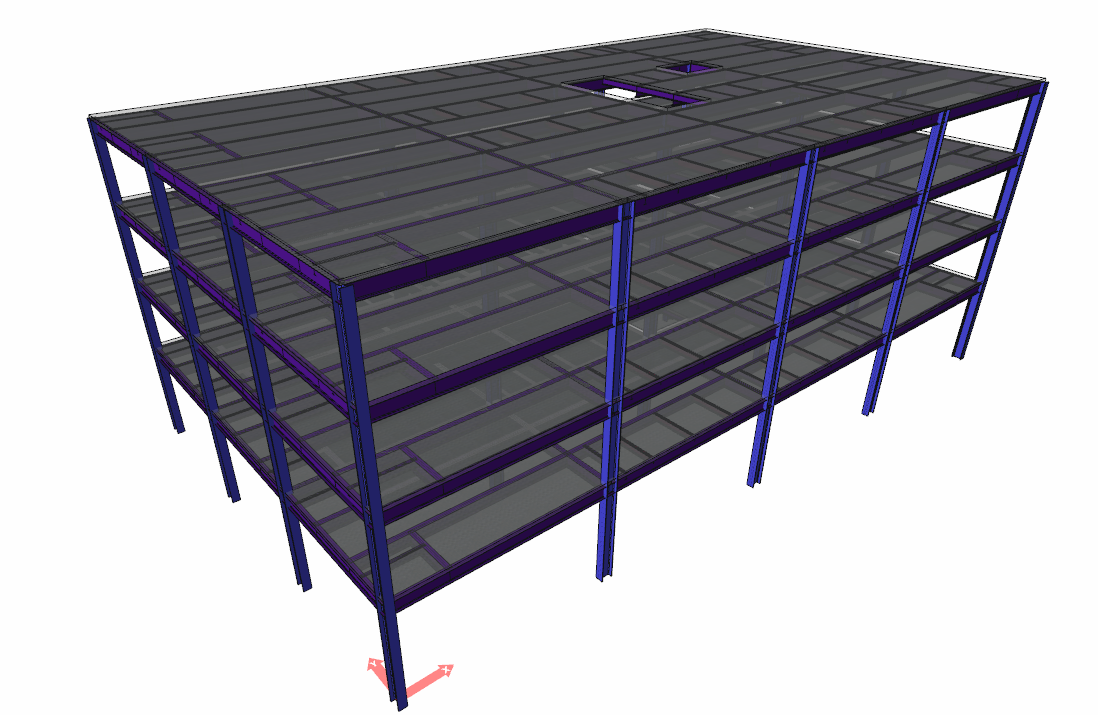

  • The building consists of 4 regular floors. The story heights are 3 m on all stories except the ground floor while the ground floor is 4 m. The total height of the building above ground level is 13 m.
Building Geometry

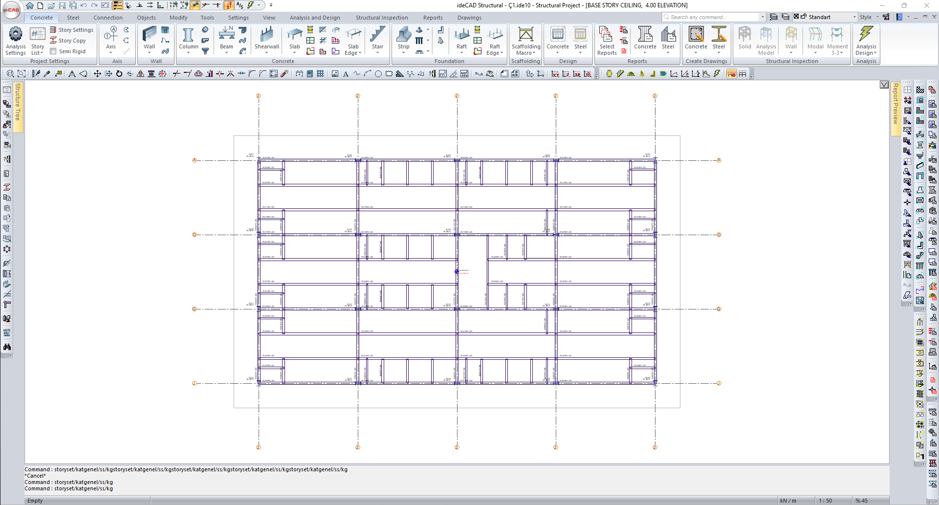

  • The building consists of 4 axes with a span of 8 m in the X direction and 3 axes with a span of 6 m each in the Y direction.
  • The building is totally 32 m in the X direction and 18 m in the Y direction.
  • The building geometry is shown in the formwork plan and perspective view below.
  • Structural system is chosen moment resisting frames.
