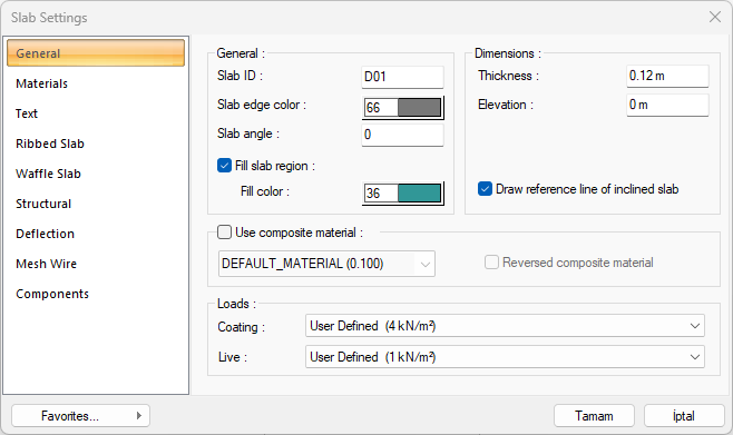

  • Area distributed load on the story is applied as 0.5 kN/m2 in the basement stories, 4 kN/m2 in the roof floor and 1.5 kN/m 2 in all other stories.
  • Roof story loads can be seen in the image below.
Live Loads
  • Basement 5 kN/m2, on the top story 1 kN/m2 and all other stories 2 kN/m2 was applied load is spread over the story area as.

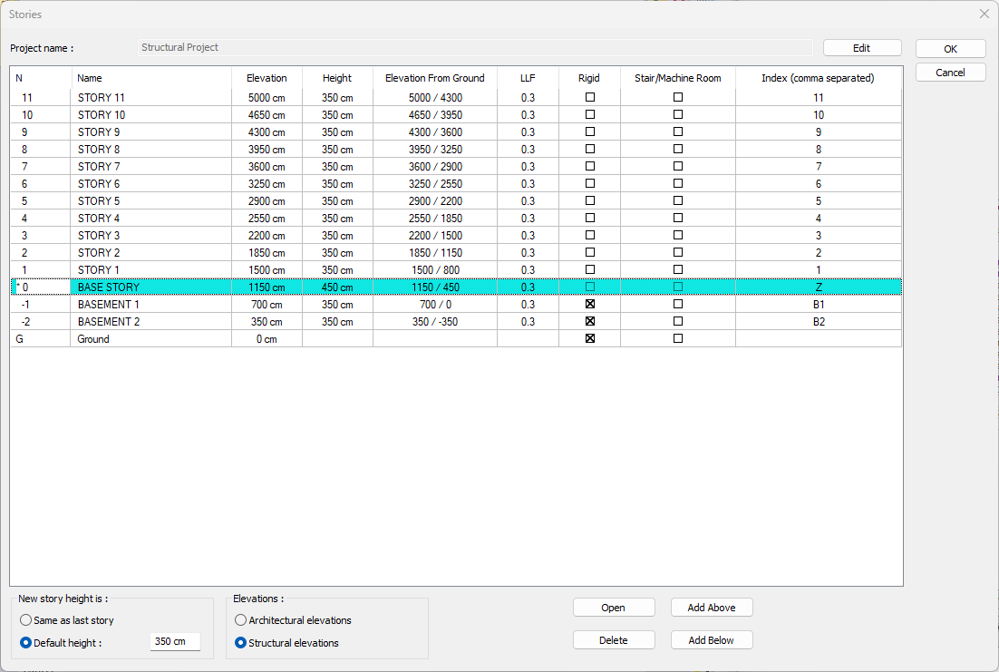

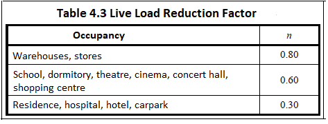

  • Live load reduction factor is determined as 0.3 according to Table 4.3 of TBDY 2018. ideCAD Structural story general settings are adjusted in HYK section. For detailed information, see: Mass Definition at Joints (4.5.9)
