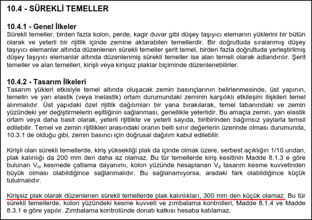

The raft foundation thickness cannot be less than 30 cm.
The Complete Message:
The raft foundation thickness cannot be less than 30 cm. (TS500 10.4.2)
The thickness of the so-called raft foundation is at least 30 cm. give.

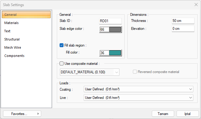

  1. Choose the raft foundation
  2. Enter the properties.
  3. In the General tab, enter at least 30 cm in the thickness line and click the OK button.
