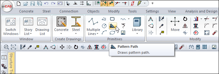

Location of the Pattern Path Command
You can access it under the Ribbon menu, Drawings tab, Primitive Objects heading.
  • Click the Pattern Path icon.

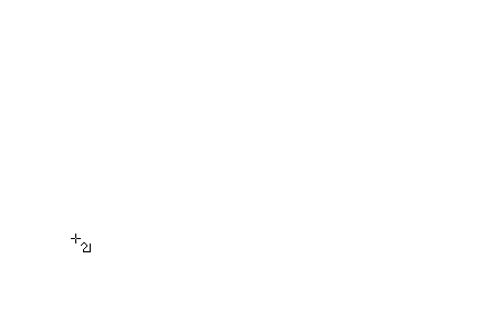

  • Click on any point in the drawing area with the left mouse button. This is the starting point of the pattern path.

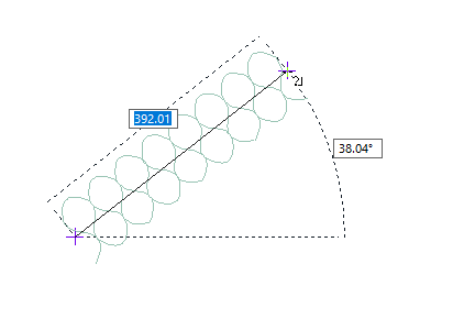

  • Drag the mouse. The preview of the pattern path will change depending on the movement of your mouse.

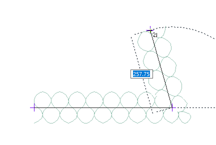

  • You can draw a straight or perpendicular edge by pressing the Shift key.

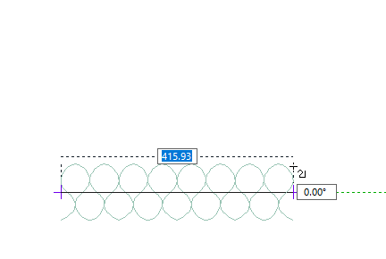

  • Click the left button to define the end point of the pattern path.

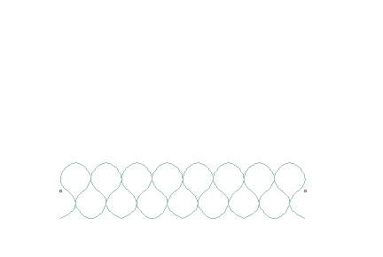

  • Pattern path will be formed.
Determining the first point for the pattern path
The formation of a pattern path with the movement of the mouse
Drawing straight or vertical edges with the Shift key
Determining the end point for the pattern path
Pattern path formation
