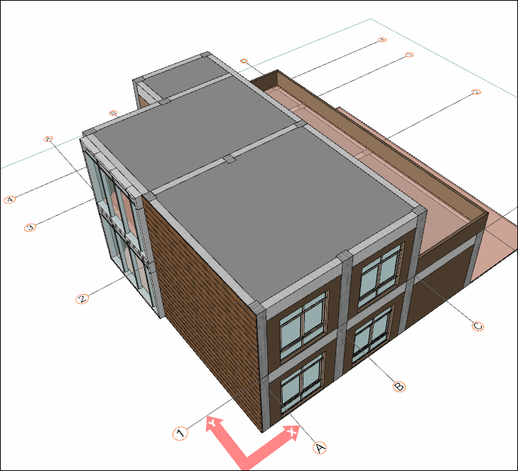

  • Enter the slab command from the concrete menu.

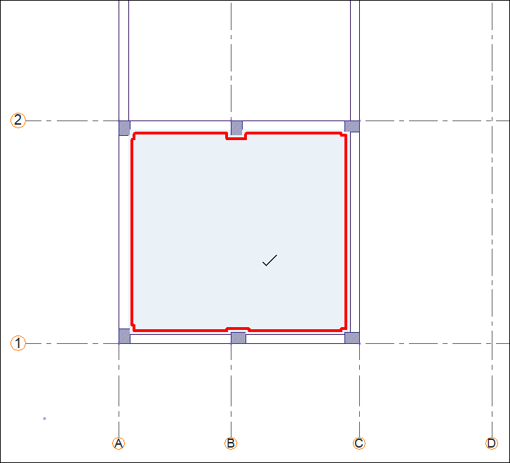

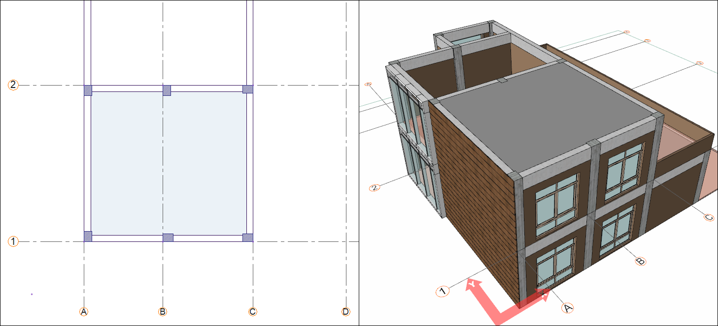

  • Move your mouse over the area delimited by axes 1-2 and A-C, and click the left button.
  • The slab will be formed.

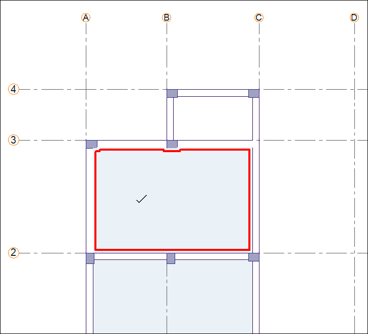

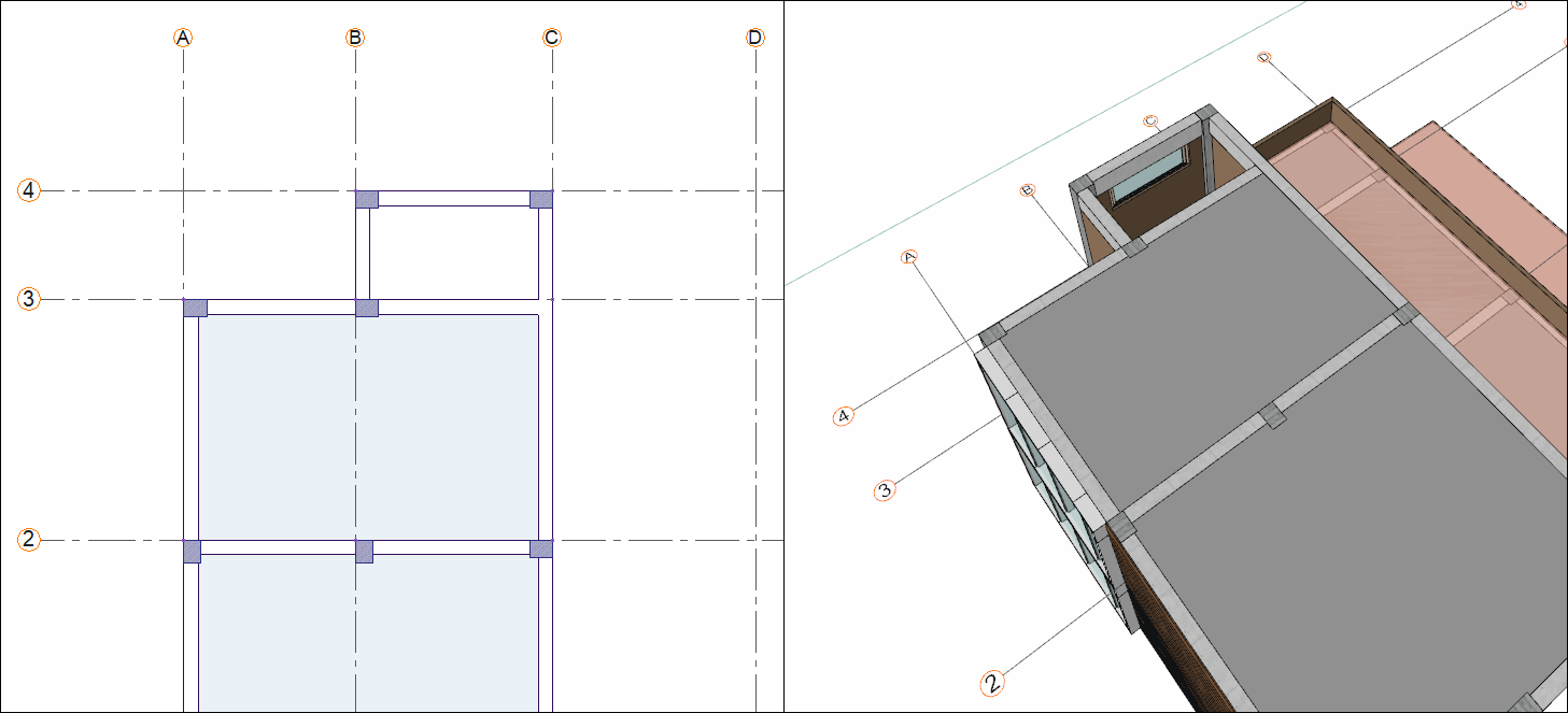

  • Move your mouse over the area delimited by axes 2-3 and A-C, and click the left button.

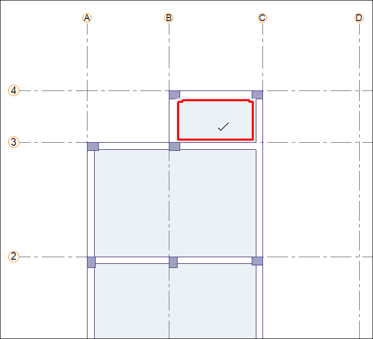

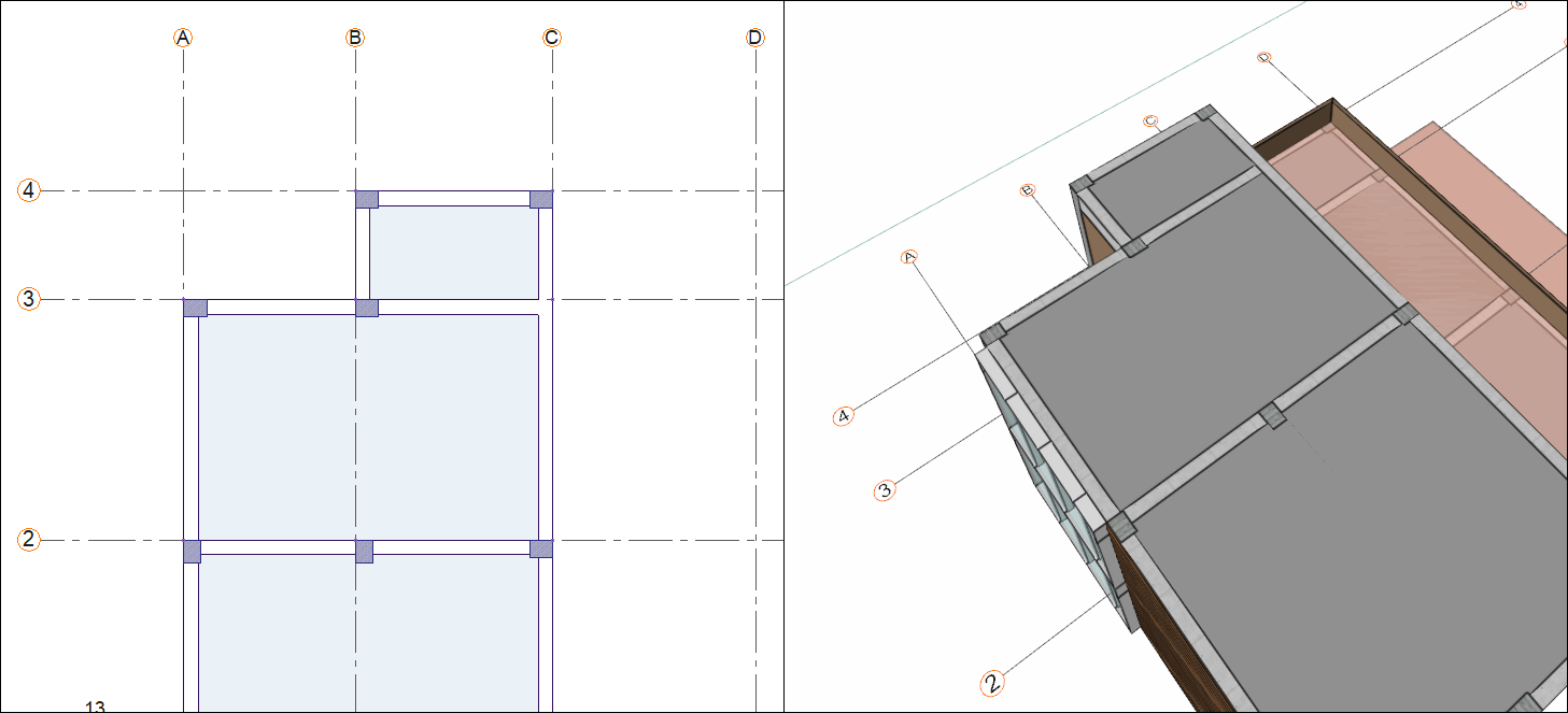

  • Move your mouse over the area delimited by axes 3-4 and B-C, and click the left button.
  • Press the Esc key on the keyboard to exit the command. The upper story slab has been completed.
