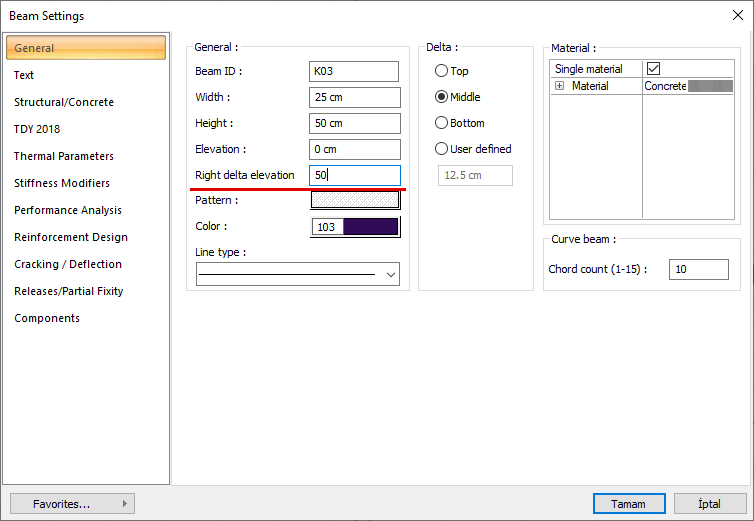

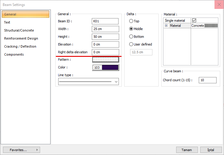

You can access the right delta elevation feature from the Beam Settings dialog.
  • Select the beam you will incline and enter its settings.
  • Enter the elevation value in the right delta elevation line.
  • Your beam will change according to the value you enter.

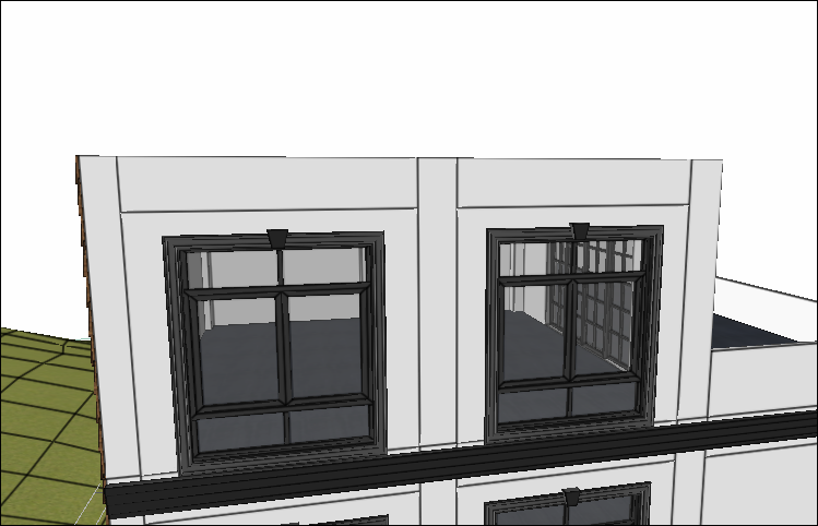

Beam before right delta elevation changes

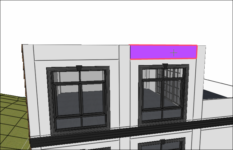

Choosing the beam to be inclined

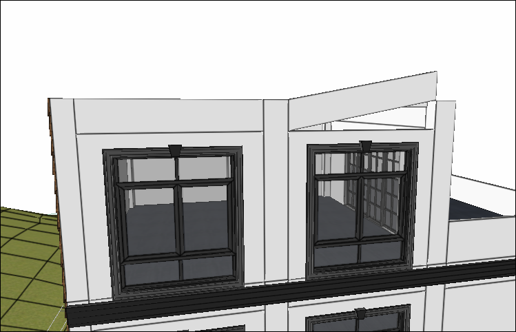

Entering a value to the right delta elevation
Beam after right delta elevation change
