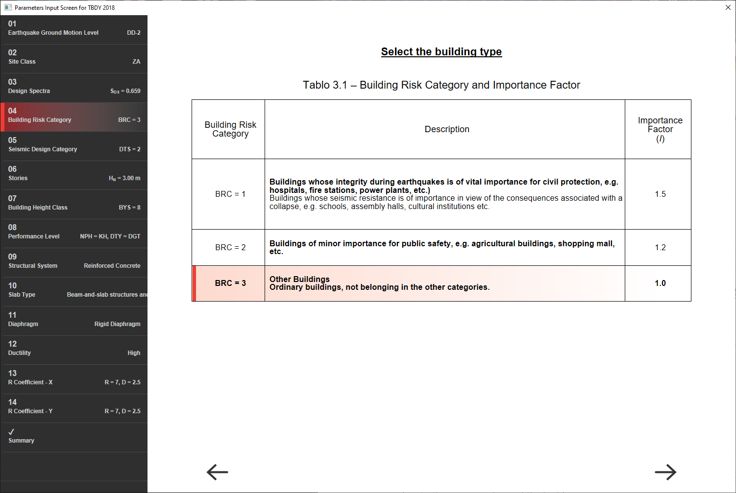

Building Usage Class defined in Table 3.1 of TBDY 2018 is selected from the table in the wizard according to the purpose of use of the building.
