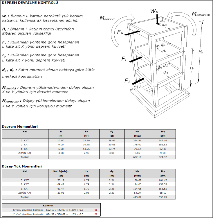

Earthquake overturning moment control in (X / Y) direction could not be achieved.
This message is given if the ratio of the sum of the overturning moments for the whole structure, the sum of the protective moments, is greater than 0.5.
Intermediate values ​​and control results are given in the Earthquake Tipping Control report.
