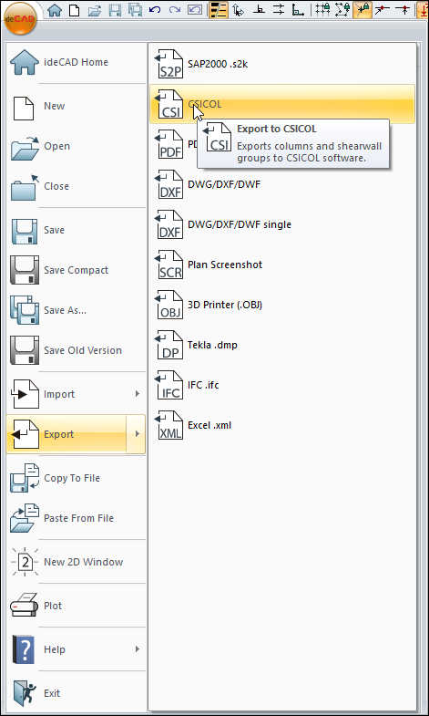

You can access it from the menu under the ideCAD logo in the upper left corner of the screen in the ribbon menu.
To transfer selected columns/shearwalls to CSICOL;
  • Columns/shearwalls to be transferred are selected in the plan window.
  • Click the İdeCAD logo in the upper left corner.
  • Click the Export/CSICOL line from the menu that opens.
  • A folder is selected and the OK button is clicked.
