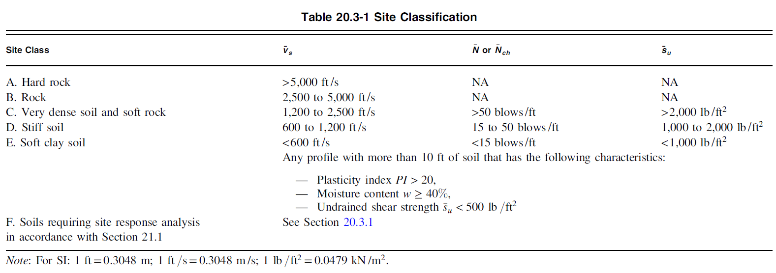

When the ground class is F, data entry is made from ‘Define’ command at the Analysis Settings / ASCE 7-16 Design Spectrums tab and import the spectrum as a .txt file by user.
A selection is made from the table according to the local soil class given in the ground survey report prepared in accordance with ASCE 7-16 Table 20.3-1. If the ground class is F, data entry is made from the Analysis Settings / ASCE 7-16 Design Spectrums tab.
