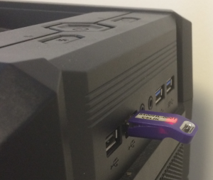

  • The dongle must be plugged into one of the USB ports before the program runs.
  • If the dongle is not installed, insert the lock and wait for the light of the lock to turn on.
  • The lock light should be on (example shown in screenshot). When the light turns on, run the program again.
  • If the lock is not lit, test your lock on other ports on the computer to see if the USB port where the lock is attached is defective.

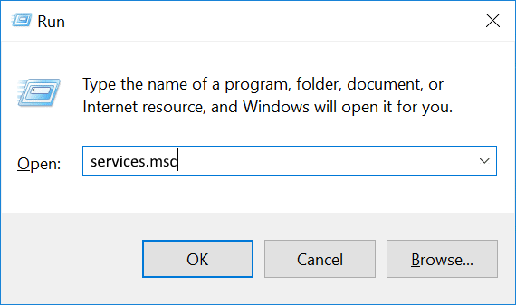

  • Write services.msc on Windows/ Start Menu/Run line and press Enter.
  • The Services dialog will open. Find the Sentinel License Manager line in the list.

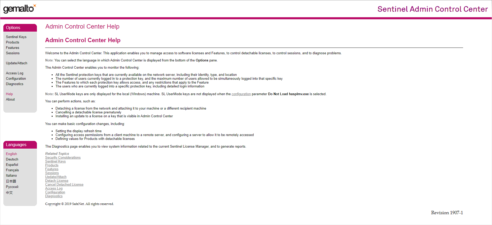

  • Open the internet browser.
  • In the address line type http://localhost:1947 and press Enter.
  • The Admin Control Center Help window will open. This window contains information about the dongle.
  • If you are getting the page did not display error message, port 1947 may be blocked.
  • Check if port 1947 is blocked in the Windows firewall. Unblock port 1947.
  • Some security programs may have blocked the Hasp program or port 1947. In the security program, disable the program c: \ Windows \ system32 \ hasplms.exe and / or port 1947.
