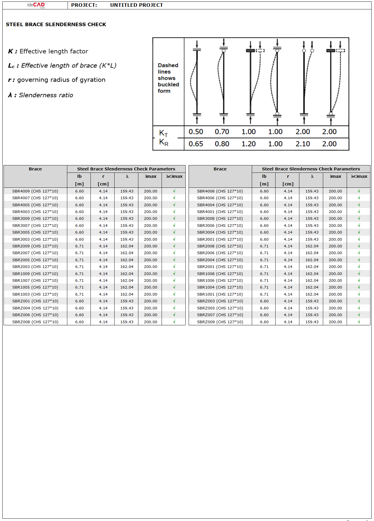

How does ideCAD control the slenderness ratio according to AISC 341-16?
  • ideCAD Structural controls and reports brace slenderness ratio automatically.
The slenderness ratio control is done automatically by a steel frame with a moderate ductility level and reported on the steel brace member report.
