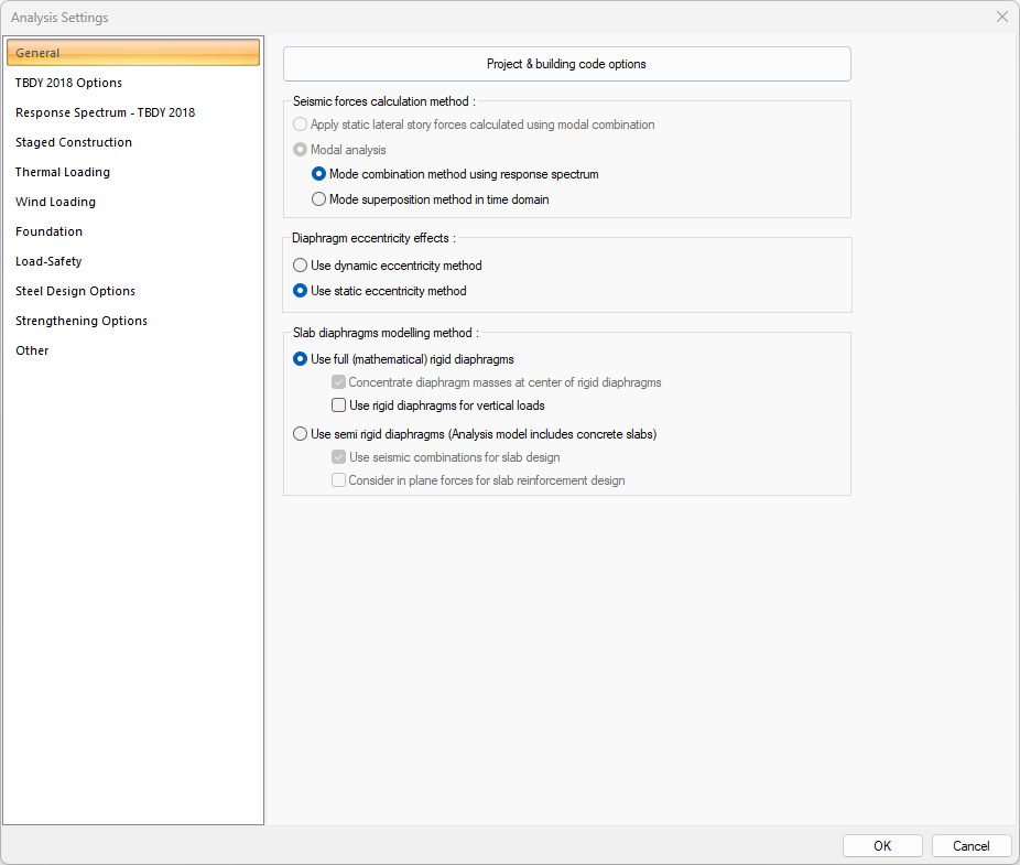

In the Analysis Settings wizard of the building information model whose structural system is being examined, project and building code options are set.
  • Click on the Analysis Settings command.
  • In the General tab, click the Project & building code options button.

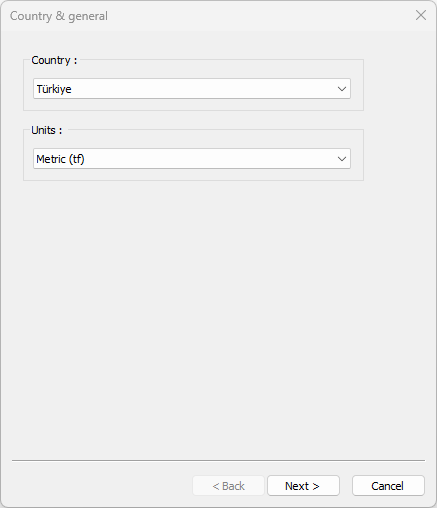

  • In the Country & General dialog, select Türkiye for country and Metric (tf) for units and click the next button.

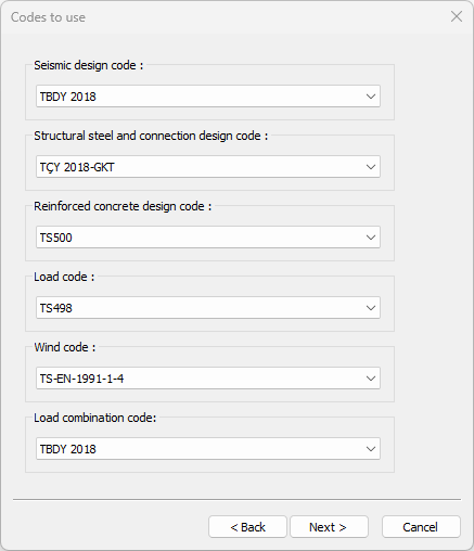

  • The Codes to use dialog will open.
  • For seismic design code, select TBDY 2018, for structural steel and connection design code TÇY 2018-GKT, for reinforced concrete design code TS 500, for load coda TS 498 , for wind code TS-EN-1991-1-4 and for load combination code TBDY 2018. Click the Next button.

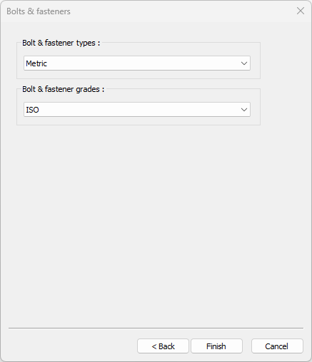

  • In the Bolts & fasteners dialog, select Metric for bolt & fastener types and ISO for bolt & fastener grades and click the finish button.

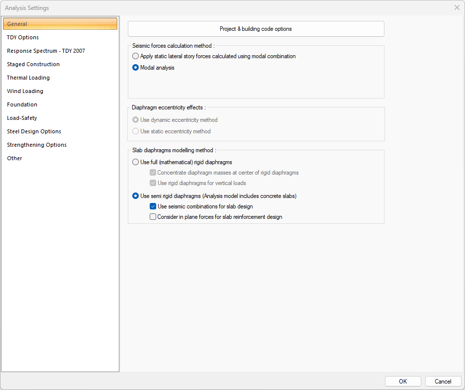

  • The selected project and building code options will be applied to the project.
After the code change is made, the project should be analyzed again.
