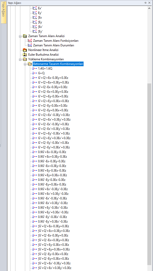

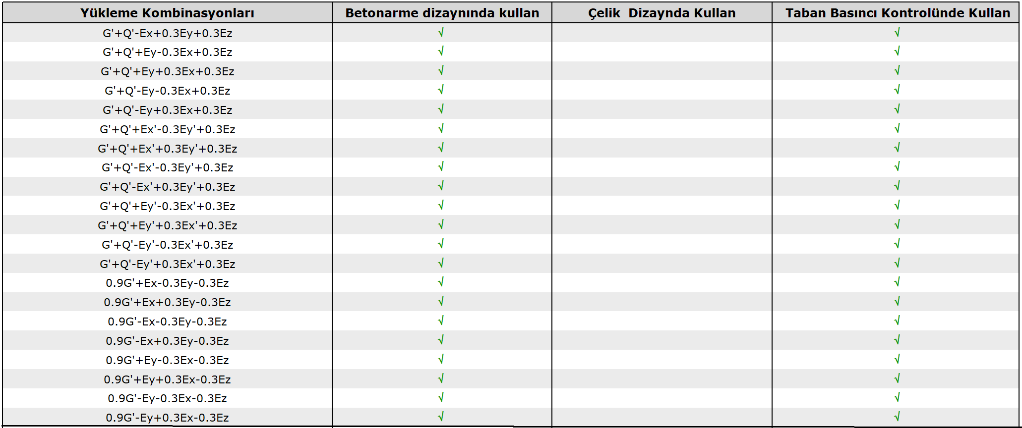

Load Combinations of Earthquake Effects for Perpendicular Directions (4.4.2.1)
The edited combinations are given under three headings: reinforced concrete, steel and user-defined under the subtitle of building tree loading combinations in the interface. All combinations used for reinforced concrete, steel and base pressure control are given in the subtitle of optional report loading situations and loading combinations.
