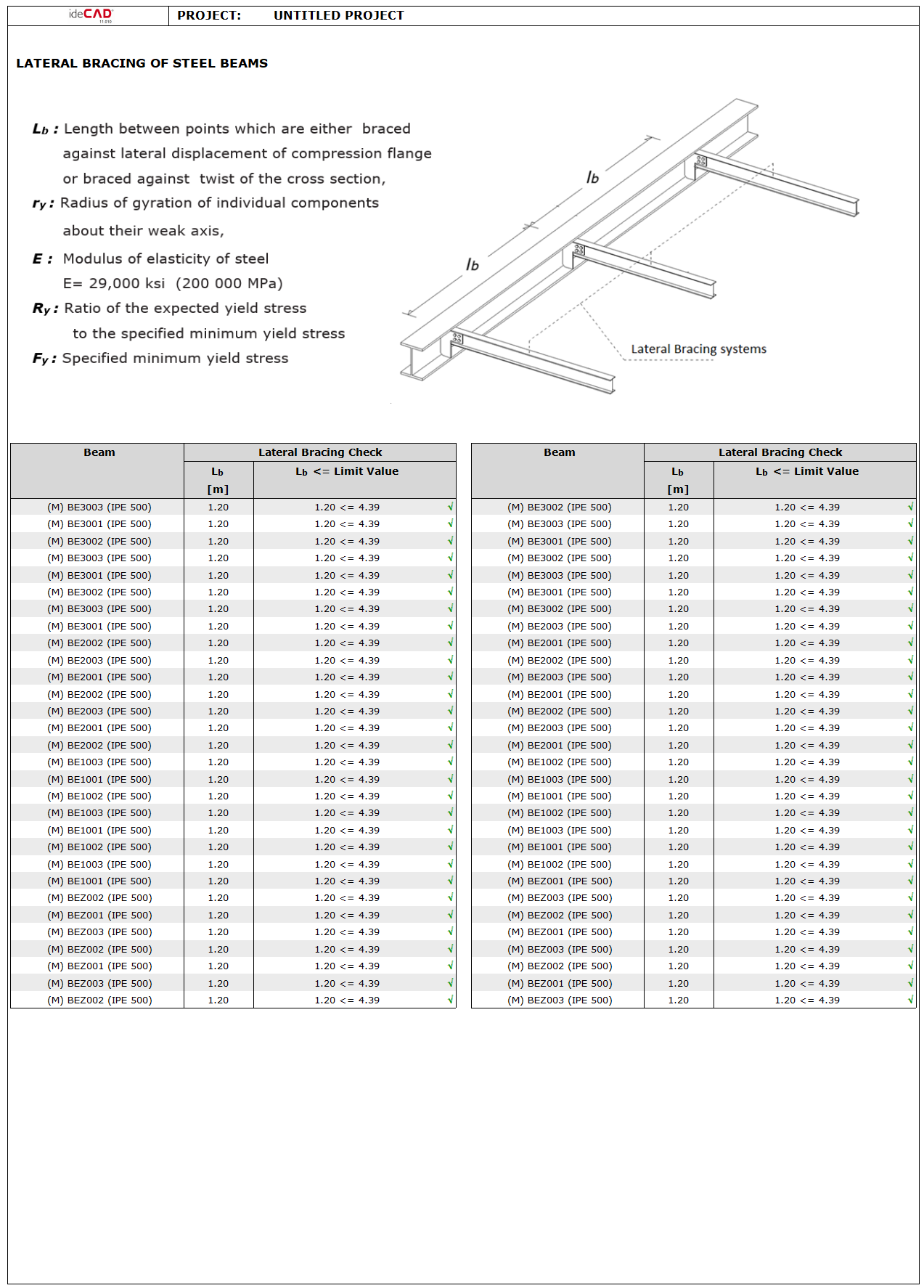

How does ideCAD control stability bracing for columns and beams according to AISC 341-16?
  • Stability bracing control is done automatically and reported on the beam members of the moment resisting steel frame with high ductility level.
This control is done automatically and reported on the beam members of the moment-resisting steel frame with a high ductility level.
