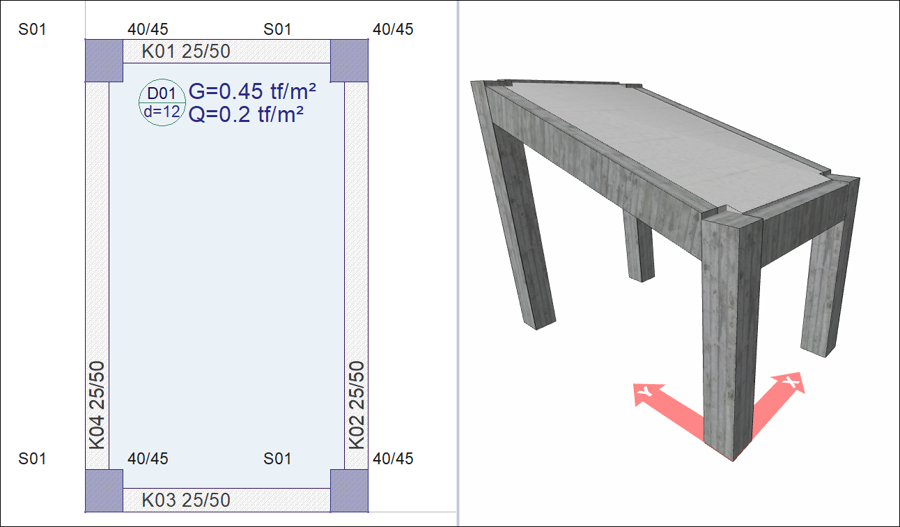

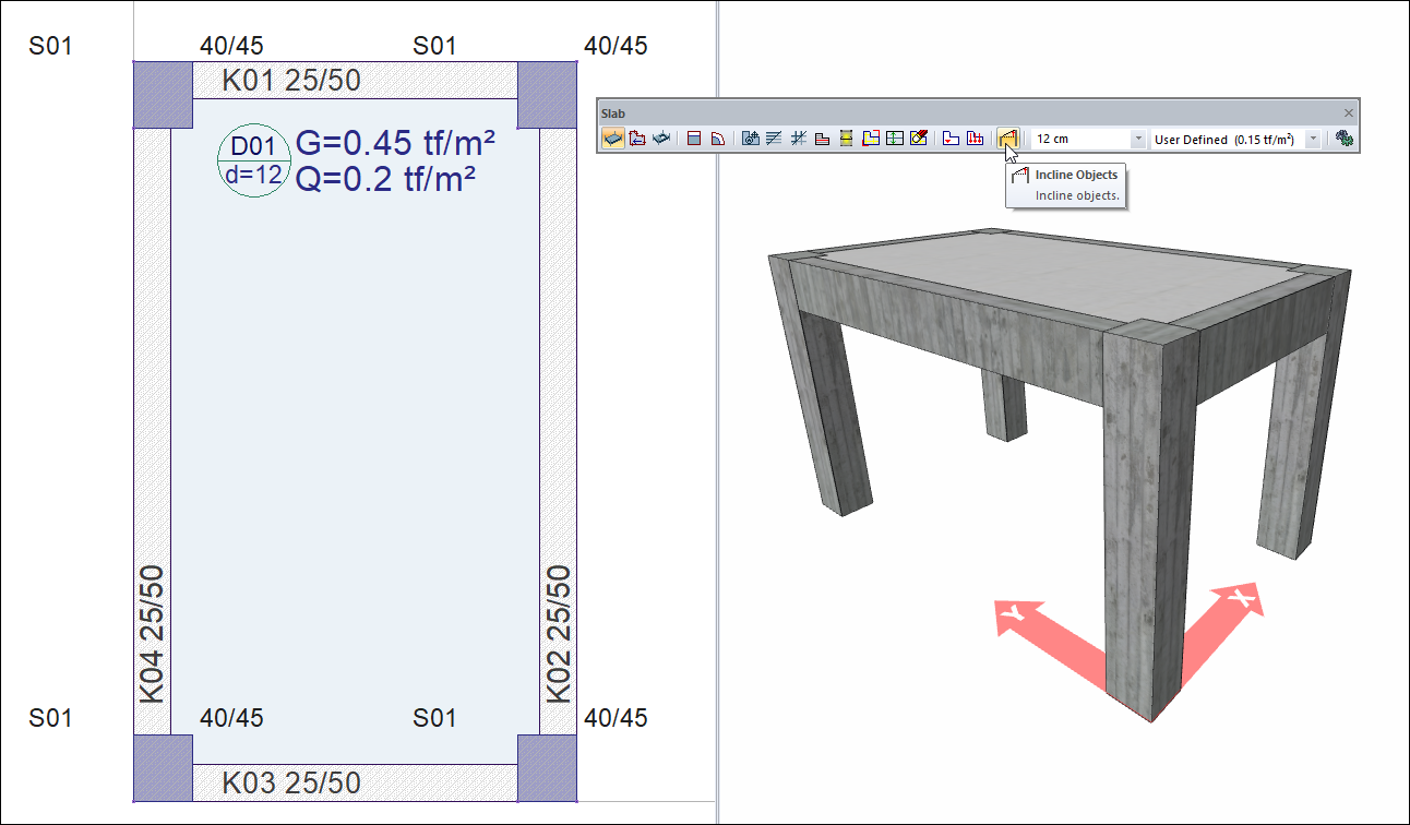

Slabs are inclined with the "Incline objects" command from the slab toolbar.
To slope your slab;

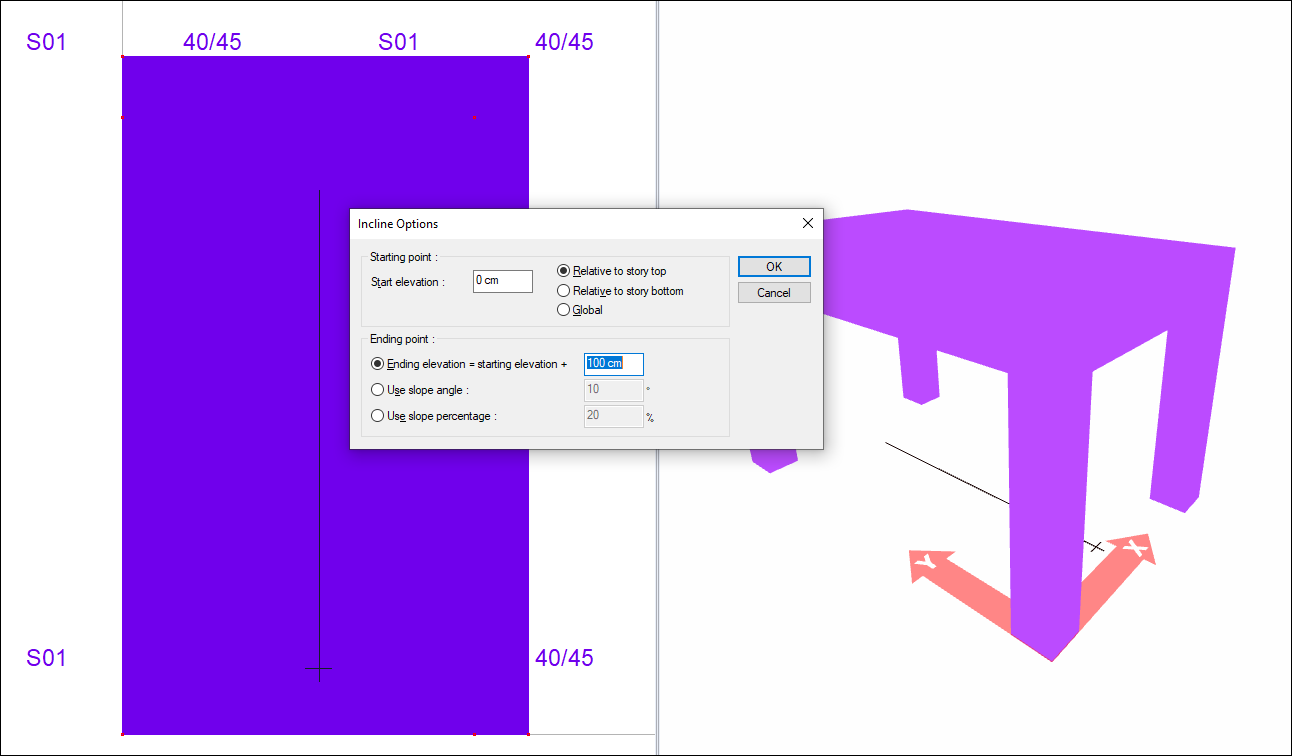

  • Click on the Incline objects icon from the slab toolbar  .
  • Select the slab you want to bevel and click the right mouse button.
  • From the dialog that comes up, determine whether or not to select objects around the slab.
  • Draw your reference line to determine the direction of the slope.
  • Make your settings in the incline options dialog.
