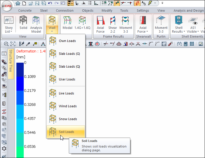

Location of Loads View Feature
You can access the Loads tab by clicking one of the load type commands under the Loads heading under the Ribbon menu Structural Inspection tab .
You can also access the Loads tab by clicking the Analysis Model command under the ribbon menu Concrete tab Structural Inspection title .

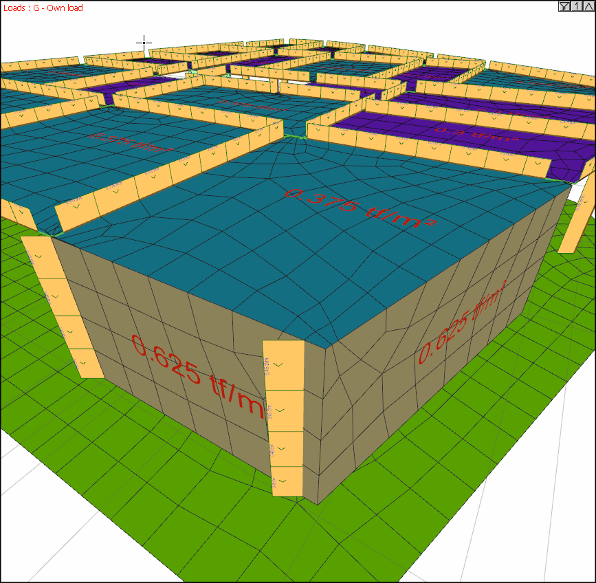

Own load
It shows the loads caused by the weight of the structure.

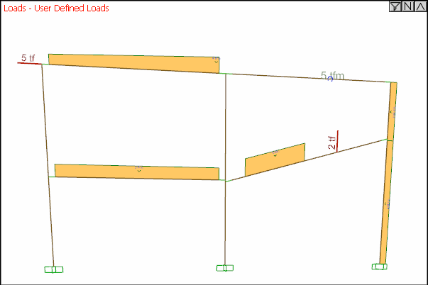

User defined loads
It shows the loads that the user defines on elements or nodes.

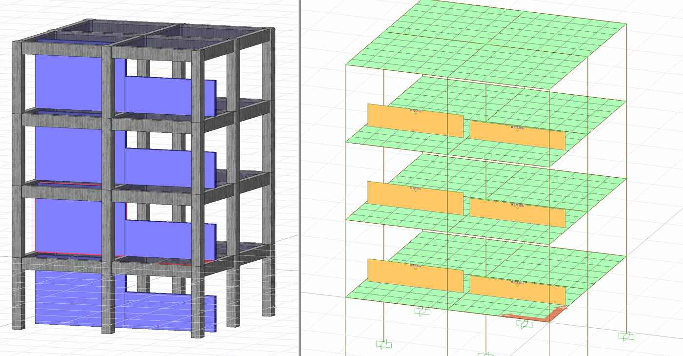

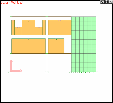

Wall loads
It shows the wall loads defined on the building elements.
Wall loads
Wall loads defined to floors are also shown in the analysis model.

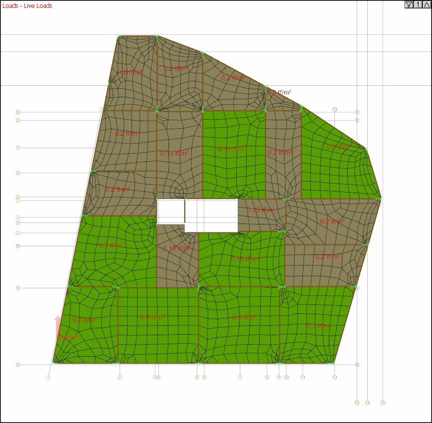

Live loads
It shows the live loads defined in the elements.

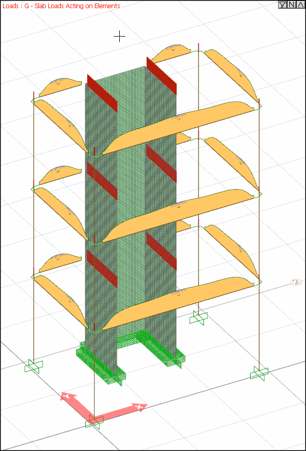

Slab loads acting on elements
It shows the loads transferred by slabs to building elements.

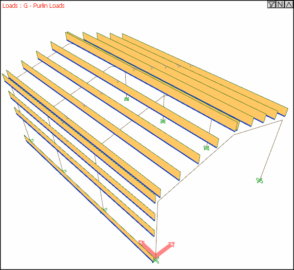

Purlin loads
It shows the loads acting on the purlins.

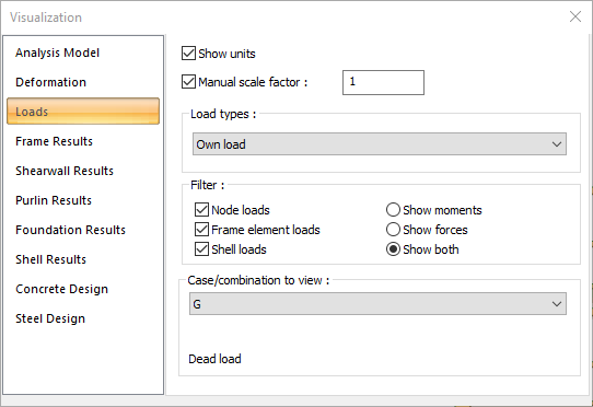

Loads Tab
Show units
If marked, the units belonging to the loads will be shown on the structure.
Manual scale factor
If the option is not selected, the scale factor deemed appropriate by the program is applied for load diagrams. If checked, the desired scale factor value can be entered manually in the box on the left.
Load type
The issue that needs to be taken into consideration when examining the load types is that after selecting the relevant load type from the list, it is necessary to select the correct load condition under the Combination title. Otherwise, the loads to be analyzed will not be displayed in the image window.
Filter
If the "Node loads, Frame element loads, Shell loads" lines in the list are checked, the loads for all elements are shown on the structure. Unchecking the loads you want not to show is enough to filter them from the screen. The desired option can be selected by selecting one of the "Moments, Forces, Both" options in the list.
Combination
The load cases including the selected load type are listed. The loads can be examined through the structure by selecting the appropriate load status from the list.
