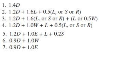

Load Resistance Factor Design is based on the principle that the strength value for all structural members is equal to or greater than the required strength calculated with the loads and loading combinations mentioned in the regulation. LRFD use different load factors for each load combinations and different reduction factors for strength.
