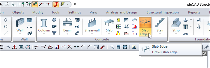

Location of Slab Edge Command
You can access it under the Concrete tab in the ribbon menu under the Concrete title.

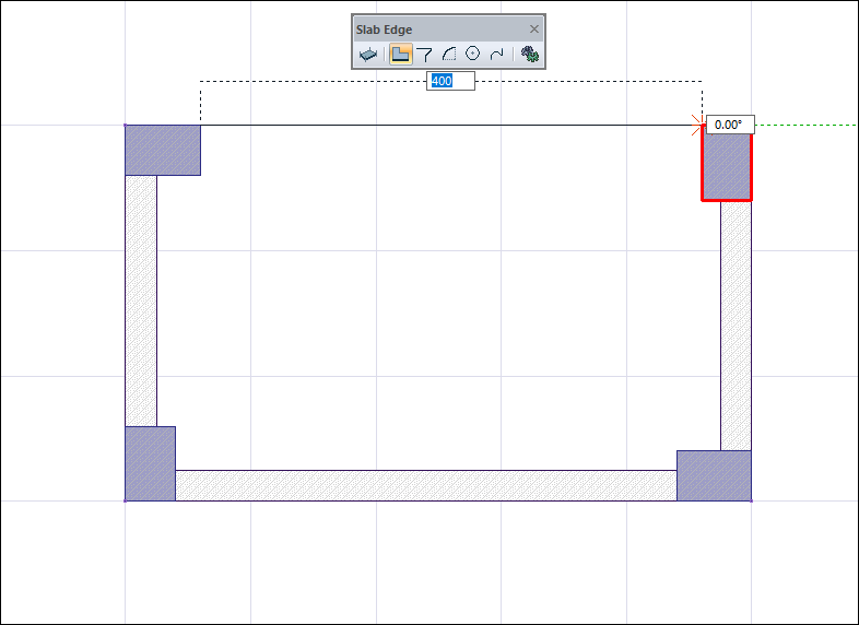

To draw a slab edge between the two columns in the image above:
  • Click the Slab Edge icon from the ribbon menu.
  • The slab edge toolbar will open.
  • Click on the end of the column with the left mouse button in the drawing area. The first point of your slab edge will be formed.

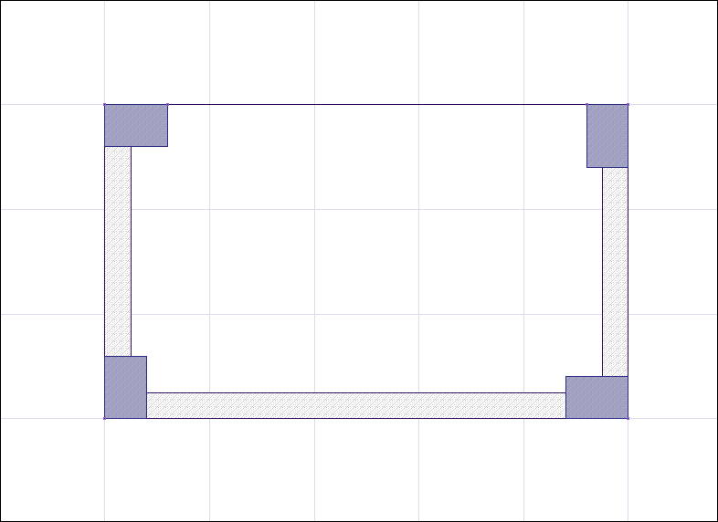

  • When you click the end of your other column with the left mouse button, your slab edge will be created.
  • Quit the command by pressing the esc key on the keyboard. You can now define slab.

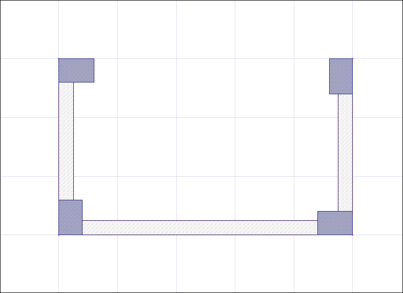

The area to be drawn edge of the slab

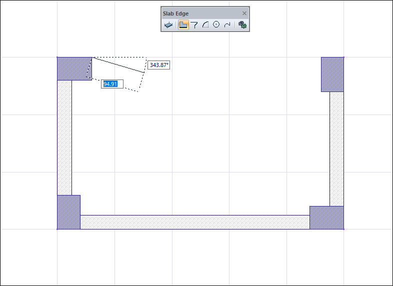

Creating the first point of the slab edge

The formation of the slab edge
