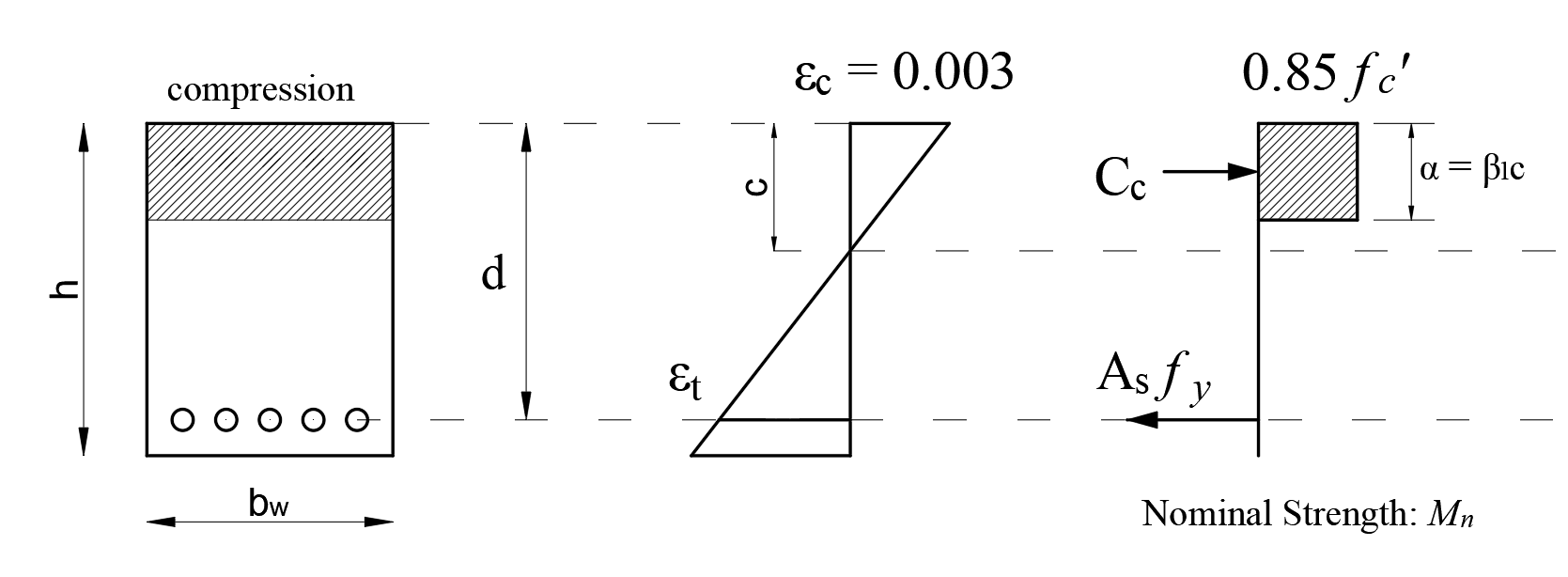

Moment
Nominal flexural strength is calculated as shown below.
