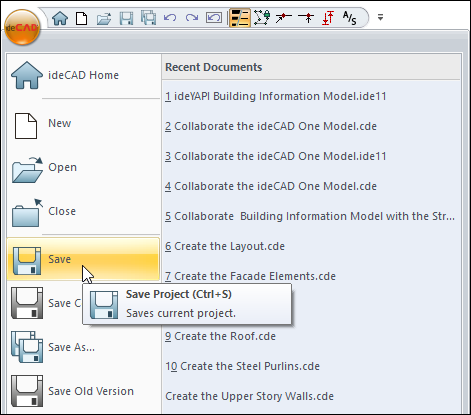

  • Click on the Save command.
  • Give the file a name and click the save button.
  • Share the resulting file with the engineer.
If you want to reduce the file size, you can save by Save Compact.
