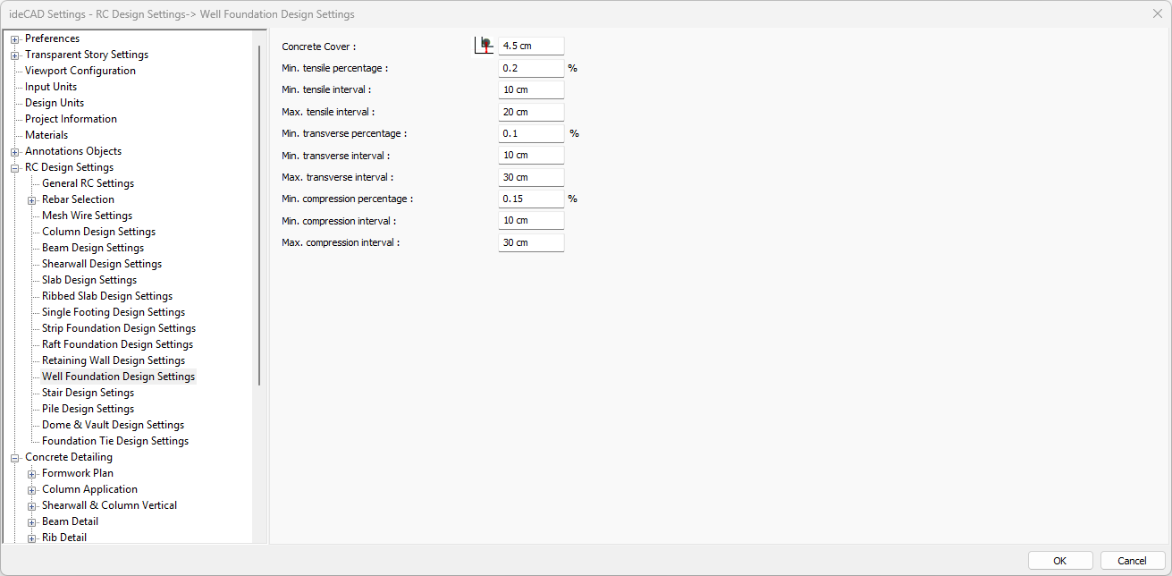

Well Foundation Design Settings Section
With the Well Foundation Design Settings, the design parameters used in the Concrete Well Foundation Design are determined. Concrete cover, maximum and minimum reinforcement interval, etc. parameters are determined from the Well Foundation Design Settings window.
Parameters denoted with “%” refer to the reinforcement ratio expressed as a percentage—that is, the ratio of the area of reinforcing steel to the gross cross‑sectional area of the concrete element, multiplied by 100.
For instance:
  • A minimum reinforcement ratio of 1% corresponds to a steel area equal to 1% of the concrete section.
  • Since a reinforcement ratio of 0.01 (i.e. 0.01 × 100) equals 1%, the value “1” should be entered for this parameter.
All percentage values must be entered as the ratio multiplied by 100. If your design software requires integer percentages, round to the nearest whole number.
Concrete cover
It is the distance from the center of gravity of the rebar to the outer face of the concrete.
Min. tensile percentage
In the tensile zone, give the minimum percentage value to be used in the rebar calculation. The entered value is multiplied by the sectional area and the rebar selection is made in a way that is not less than the result.
Min. tensile interval
In the tensile zone, give the smallest possible distance between two rebars. This value is taken into consideration in the selection of rebar.
Max. tensile interval
 In the tensile zone, give the value of the greatest possible distance between two rebars. This value is taken into consideration in the selection of rebar.
Min. transverse percentage
Give the minimum percentage value to be used in horizontal rebars. The entered value is multiplied by the sectional area and the rebar selection is made in a way that is not less than the result.
Min. transverse interval
Give the smallest possible distance between two rebars to be used in horizontal rebars. This value is taken into consideration in the selection of rebar.
Max. transverse interval
Give the maximum possible distance between two rebars to be used in horizontal rebars. This value is taken into consideration in the selection of rebar.
Min. compression percentage
In the pressure zone, give the minimum percentage value to be used in rebar calculation. The entered value is multiplied by the sectional area and the rebar selection is made in a way that is not less than the result.
Min. compression interval
Give the smallest possible distance between two rebars in the pressure zone. This value is taken into consideration in the selection of rebar.
Max. compression interval
Give the maximum possible distance between two rebars in the pressure zone. This value is taken into consideration in the selection of rebar.
