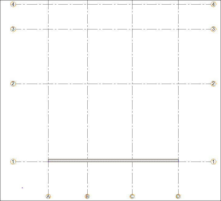

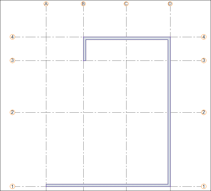

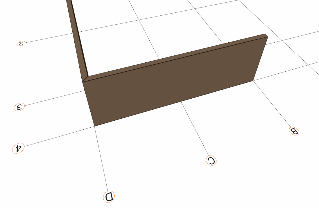

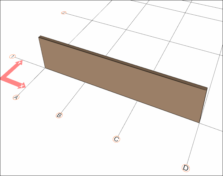

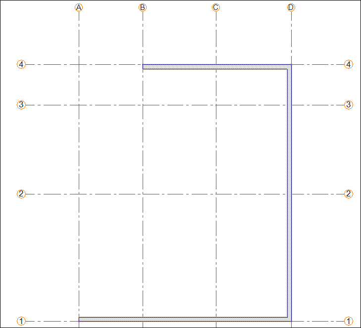

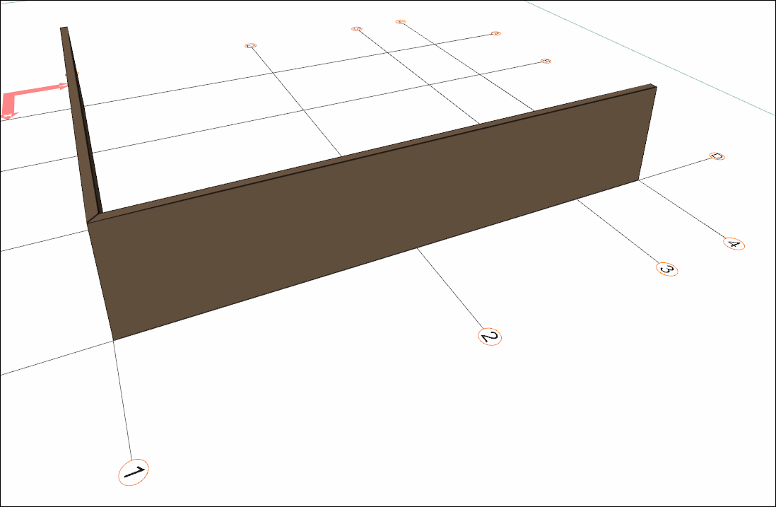

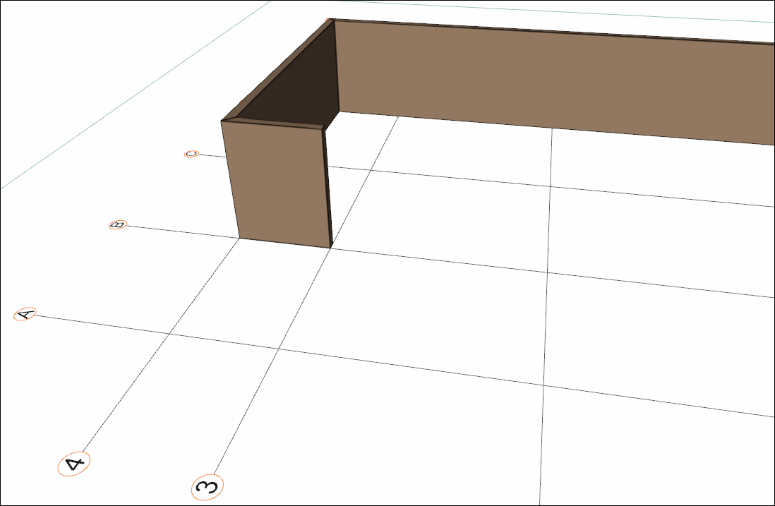

  • Click on the command Wall and click the axis intersection A-1 as your starting point.
  • Click on the D-1 axis intersection.
  • The wall will be formed between A-D axes.

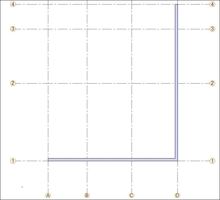

  • Click on the D-4 axis intersection.
  • The wall will be formed between 1-4 axes.

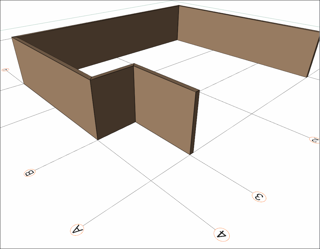

  • Click on the B-4 axis intersection.
  • The wall will be formed between D-B axes.
  • Click on the B-3 axis intersection.
  • The wall will be formed between 4-3 axes.

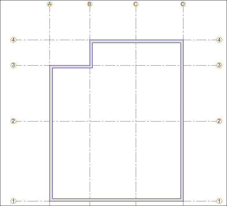

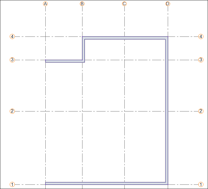

  • Click on the A-3 axis intersection.
  • The wall will occur between B-A axes.
  • Click on the A-1 axis intersection.

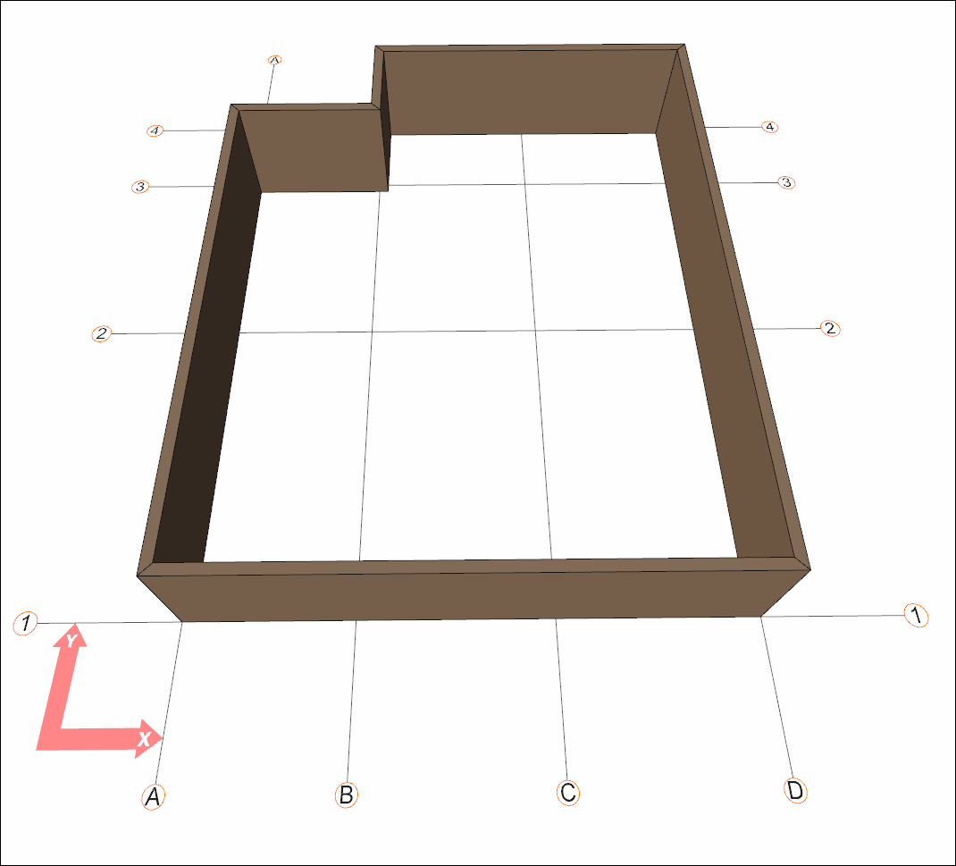

  • The wall will be formed between 3-1 axes.

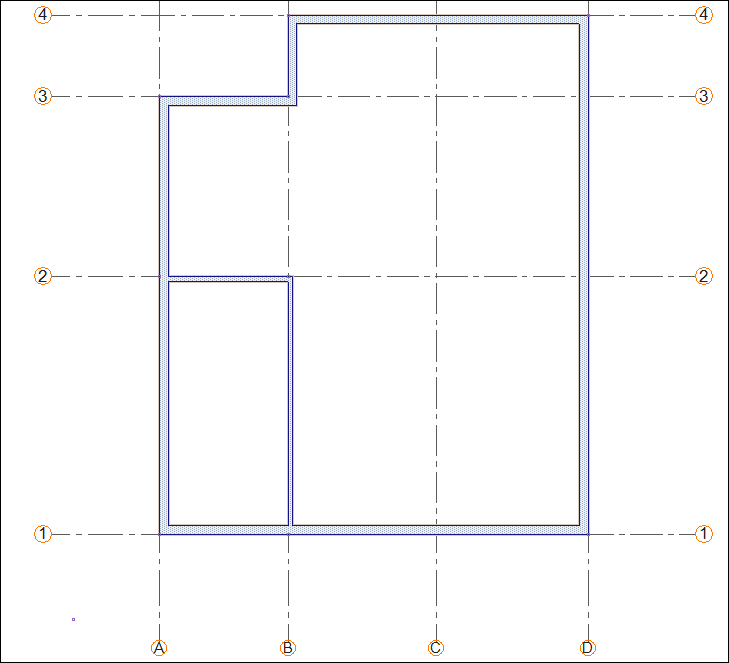

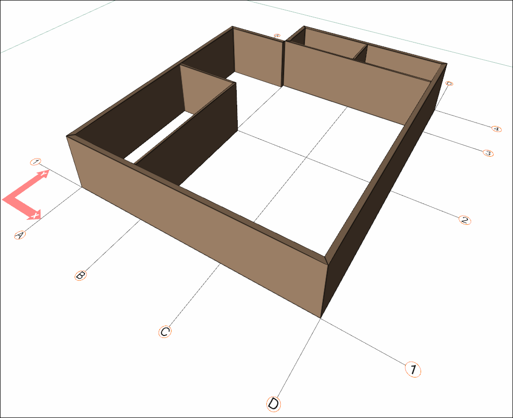

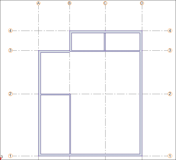

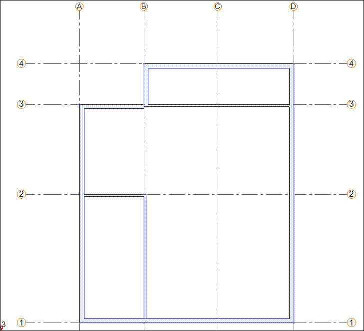

The exterior walls are completed. Start building the interior walls.

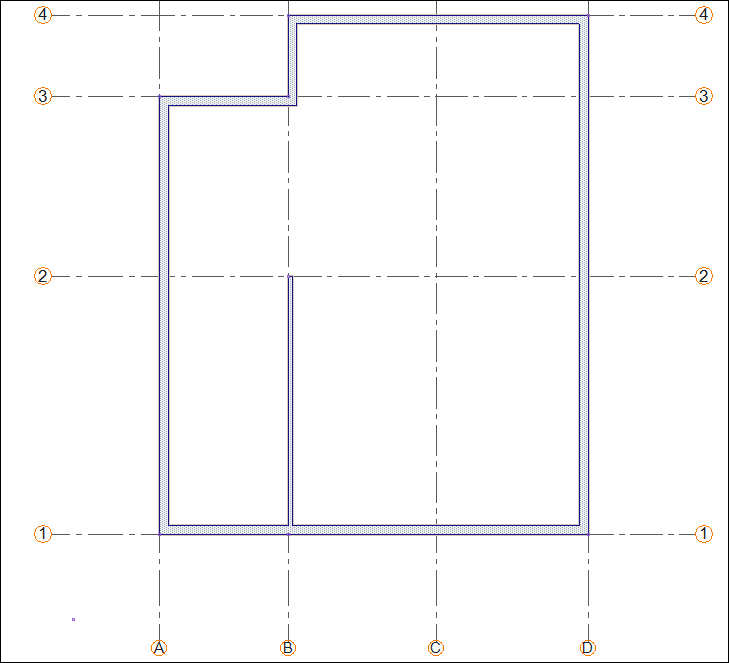

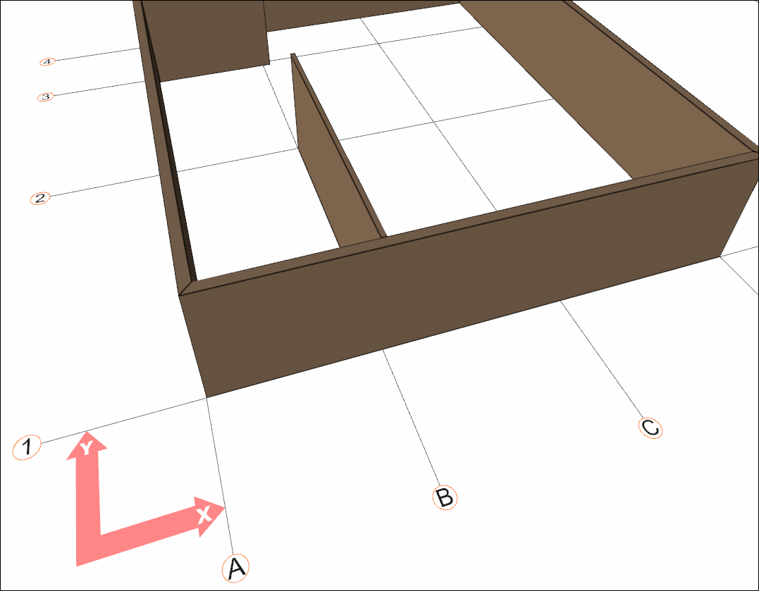

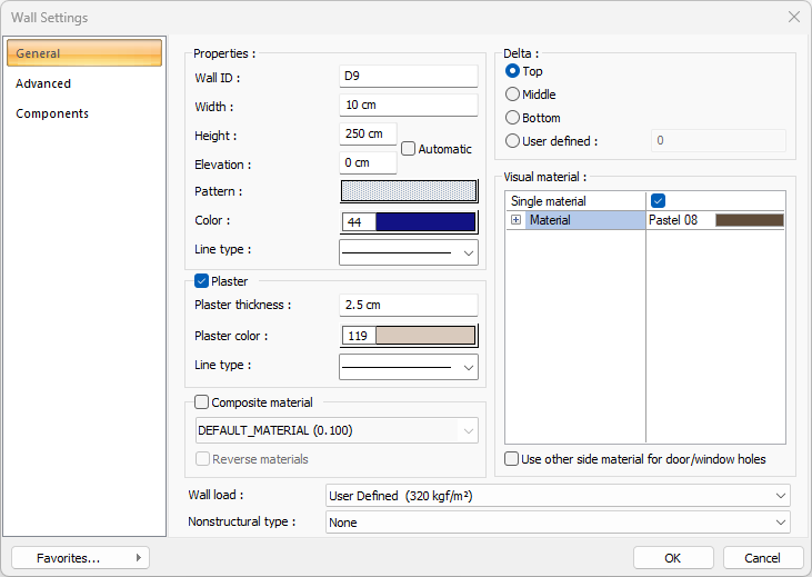

  • Click on the wall toolbar Settings icon.
  • In the wall settings dialog, enter the wall width as 10 cm and click the OK button.
  • Click on the B-1 axis intersection. Press the spacebar and slide the wall to the other side of the axis. Click on the B-2 axis intersection.
  • The wall will be formed between 1-2 axes.
  • Click on the A-2 axis intersection. Press the spacebar and slide the wall to the other side of the axis.
  • To draw a wall independent of the drawn wall, press the Esc key on the keyboard and exit the command.

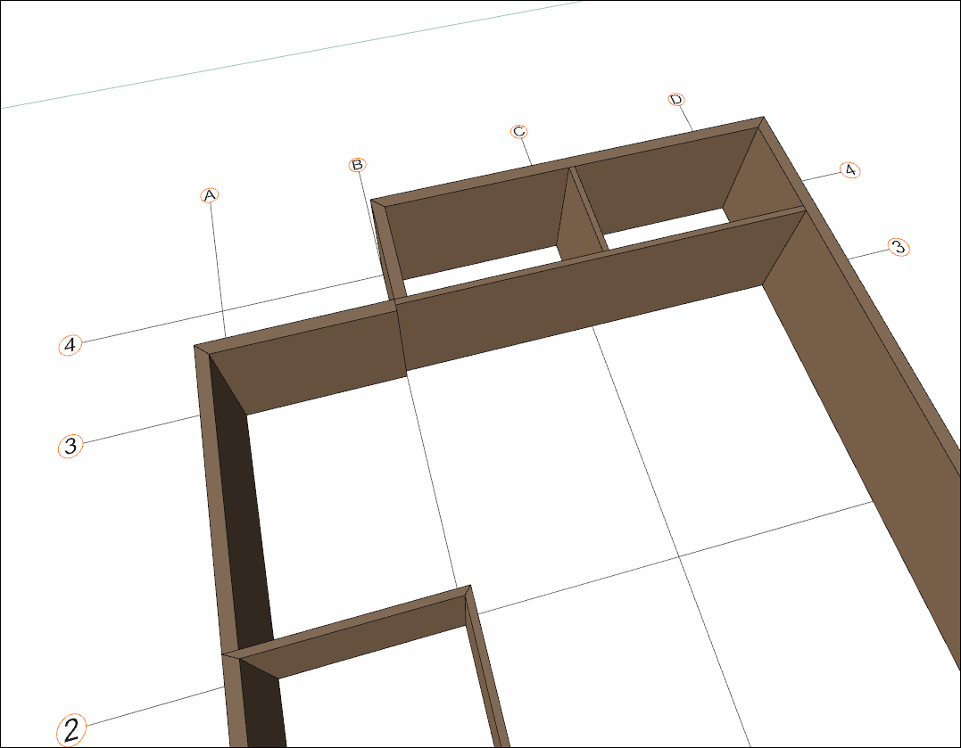

  • Click on the command Wall.
  • Click on the B-3 axis intersection. Press the spacebar and slide the wall to the other side of the axis. Then click on the D-3 axis intersection.
  • The wall will be formed between the B-D axes.

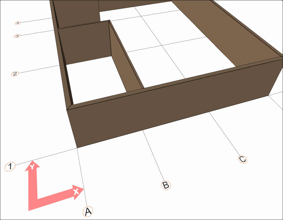

  • Click on C-4 axis intersection then click on C-3 axis intersection.
  • The wall will be formed between 4-3 axes. Press the Esc key on the keyboard to exit the command.
  • Base story walls are completed.
