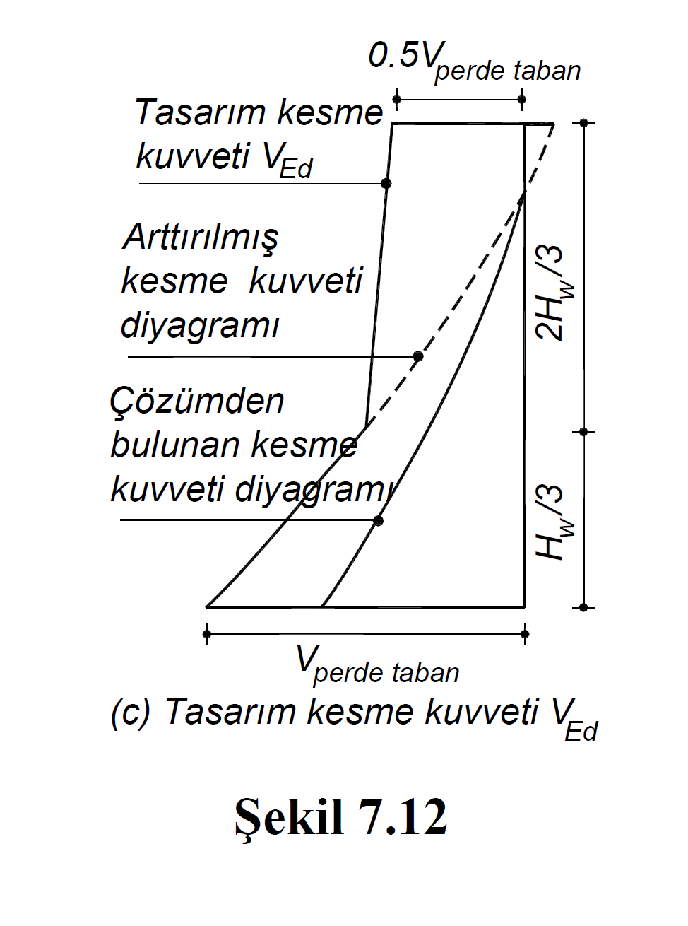

TBDY Figure 7.12 (c) shows the shear force plot of the curtain design. The design shear force at the top of the curtain will be taken as half of the design shear force generated at the curtain base. H w / 3 'to be larger than the portion H w / 3 from the highest point of the screen by shear force at the half of the pitch base received shear force combined with a linear line design shear force will be created.
The shear forces in the graph shown in TBDY Figure 7.12 (c) are explained below.
"The shear force diagram found from the solution" is the shear force diagram calculated under the combined effect of vertical loads and earthquake loads.
The diagram shown with the "increased shear diagram" is the shear force diagram resulting from the increment mentioned in the TBDY Article 7.6.6.3 . In this shear diagram, Equation. The shear force and vertical loads calculated by (7.16) are compared with the shear force value obtained by increasing the shear force calculated from the earthquake according to Section 4 by 1.2D (gapless walls) or 1.4D (bond beam walls) and the smaller shear force is taken into account. taken.
The diagram shown with "Design shear force V Ed " is the same diagram as the "Increased shear diagram" in the region of H w / 3. H w / 3 In the region above the H w / 3 points in enhanced shear-shear force is taken as half the wall base at the highest point of the screen is the shear force generated in combination with a linear line.
